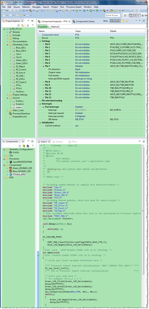

GPIO_Init can be used to configure PTA7as port interrupt.
The ISR of PTA7 need to be implemented by user.
Please refer below image:

I have configuration like your advice. My processor most of the time is in LLS mode and when edge happen on the pin (PTA7- LLWU_P3)  processor execute LLWU pin handler but does not execute port interrupt handler (where I use I2C communication).

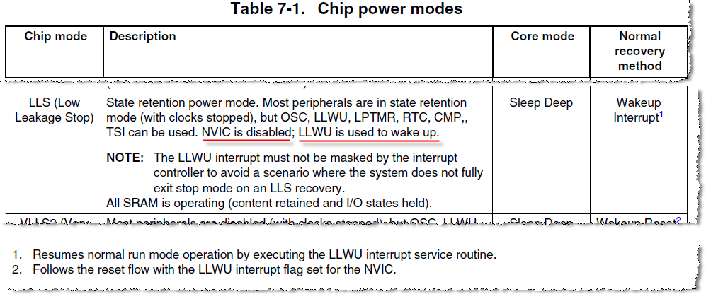

In LLS mode: NVIC is disabled and LLWU is used to wake up . (Port interrupt is not active in LLS and so it won't trigger)
When first edge happens, it resumes normal run mode operation by executing the LLWU interrupt service routine. After recovery from LLS, the LLWU is immediately disabled.
In RUN mode: the edge will cause the port interrupt but not the wake up interrupt (since the LLWU is not active  RUN mode).

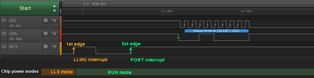

According to "I configured to waking up the processor from LLS with LLWU external pin PTA7 (LLWU_P3) on rising edge also I share the same pin as port interrupt pin on same edge detection." I think what you want is: the first edge wakeup MCU to Run mode, the second edge cause port interrupt.
I am little confuse, do you want to one edge cause two interrupts(LLWU interrupt and Port interrupt)?

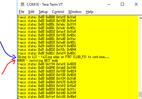

Here is the scope shot of wake-up from LLS (Channel 2 is PTA7):
This is the debug interface output:
When not in LLS mode the I2C is read as fast as possible (back-to-back requests).
Therefore I see no reason for problems waking and using I2C.
If you have a FRDM-KL05Z you can test with the attached binary. Debug is on OpenSDA UART at 115'200. Type 'L' on debug UART to switch to LLS. Falling edge on J7-4 wakes.

I understood that In LLS mode: NVIC is disabled and only LLWU is used to wake-up. In Run mode: LLWU is disabled and it detected peripheral interrupts.

In LLS mode the LLWU is active and so will wake up to RUN mode when the edge takes place.
The Port interrupt is not active in LLS and so it won't trigger.
Alternatively in RUN mode an edge will cause the port interrupt to fire but not the wake up interrupt (since the LLWU is not active  RUN mode).
This means that you will always only get one interrupt; the one depending on the mode at that point in time.

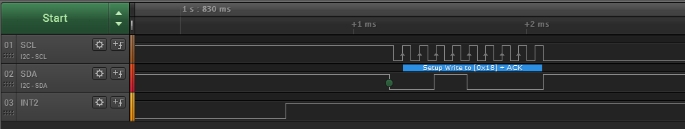

I have implemented port interrupt handler on 2 different PORT pins (PORTA and PORTB) (3-axis sensor whit 2 interrupt lines) on two different priorities. All port handlers use I2C communication and it works perfectly. I would like to implement LLS mode for low power consumption, but considering your explanation, it seems I can not share same pin edge detection.
In  Cpu_OnLLSWakeUpINT()  I check the source on wake up and read through I2C, but communication gets stuck (see picture below) -- I do not know the reason -- processor is in  RUN and as far as I know all activities should work normally. Do you have any idea?

If I understand correctly you have woken the processor from LLS mode with a LLWU port event, which you detect as the reason and use it to start an I2C operation. The I2C operation, however, doesn't continue as expected after the slave address has been sent (and acknowledged).
Since the I2C operation looks OK I would suggest that you have a problem with its interrupt no longer being detected(?)
I don't know the libraries that you are using but in case of problems there is a complete solution for your device at http://www.utasker.com/kinetis/FRDM-KL05Z.html which includes all low power modes, I2C and everything that a KL05 needs and has been proven in product use. It allows the KL05 to be simulated in (approx.) real time (including I2C devices). The binary at the link includes accelerometer operation on the FRDM board and also low power modes.

Your image shows that the processor wakes up and sends something across the I2C bus. It shows that the I2C slave ACKs, but the master holds the SCL line low.
You need to compare this with the "good" case and work out what the 'difference' is and then 'why' there is the difference.
I as assuming that the I2C driver is interrupt driven and that is why I suggested that maybe you have no more interrupt from it after waking - possibly explaining why it behaves differently. Possibly you move back to LLS mode again before the I2C transmission has completed (?)

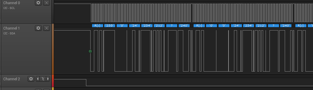

I tested reading trough I2C before put processor in LLS mode and work fine. (see picture below). After that, I put the processor in LLS mode.
Then I trigger the wake-up pin PTA7 and in LLWU handler read again, I2C get stuck also processor get stuck. The CI2C1_OnMasterBlockSent() and CI2C1_OnMasterBlockReceived() does not execute. (picture in the previous post)
