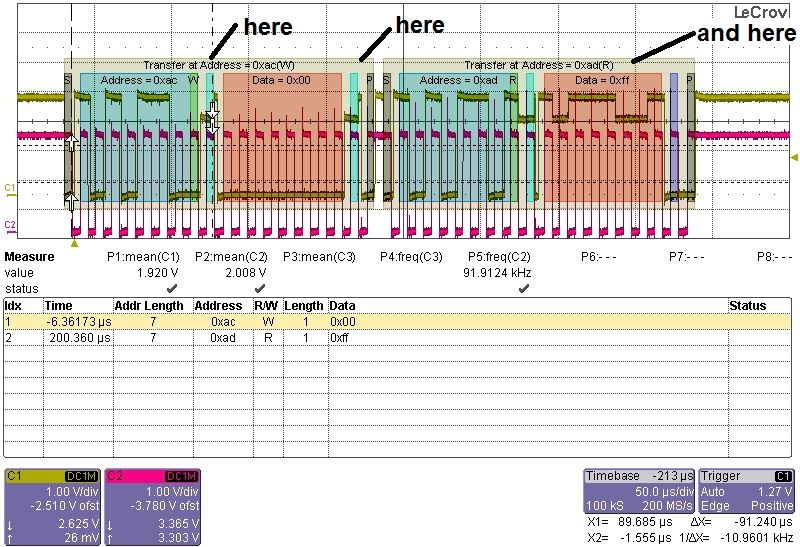

I work on a K10 and i would like use I2C to communicate with an RTC (rv-3029)
When i write on the bus, it's works perfectly. But, when the RTC send à ACK or a Data, it result an middle state (like the pictures)
it's seems good, except this half state
I try to configure the Open drain on the port, but the flag busy is always set after that.
PORTB_PCR0 = 0|(PORT_PCR_MUX(0x2));
PORTB_PCR1 = 0|PORT_PCR_DSE_MASK|(PORT_PCR_MUX(0x2));
Thx for reply

Since the I2C SDA is a digital pin function, you need to make it open drain using the ODE bit in the pin configuration register. I wrote a note two weeks ago, please look for "Kinetis I2C ODE".

gaelsieber
Thanks for reply
i've read your note and i succeed to correct my code, I had a problem with the pin configuration AND with my i2c sequence but it's corrected now.
