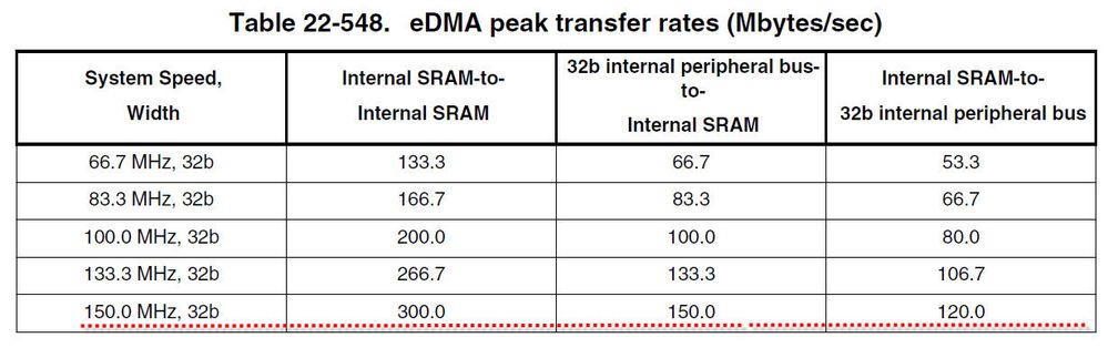

The K60 reference manual with below eDMA peak transfer rates table:
This is based on all accesses are 32-bits with address aligned.
And DMA trigger request response time also need be consider.

I believe that I am getting 150MBytes/s SRAM->SRAM which would be only half the rate that you expect (?)

For K60 100MHz product DMA performance should be 200MBytes/second, while I test result is 99MBytes/second.
I am checking with Kinetis product team about this issue.

That is the same transfer speed as I get (1MByte/s per MHz system clock).
I am wondering whether the specified 200MBytes/s for SRAM -> SRAM [at 100MHz system clock] is 100MBytes/s for the read and 100MBytes/s for the write and so in total 200MBytes/s but total transfer still 100MBytes/s (as a peripheral <-> SRAM transfer is specifed as)???

When use DMA access SRAM with 32-bit transfer size setting at TCD Transfer Attributes (DMA_TCD_ATTR), there with one wait state during each read/write. That's why the DMA performance doesn't up to 200MB/s.
Please try to modify the DMA transfer size to 16-bytes or 32-bytes(Kinetis 100MHz silicon V2.x) at DMA_TCD_ATTR register, it will enhance the DMA performance.

When I test on an MK60NF1M0VMD15 (mask 3N96B) I get 99MBytes/s* when all transfers are 32 bits in size TCD Transfer Attributes (DMA_TCD_ATTR).
When I change the attributes to 16 bit transfers the throughput reduces to 50MBytes/s*.
[clocked at 100MHz - 1.5x faster when clocked at 150MHz]
1. This means that I don't see how decreasing the transfer width can help since it requires twice the amount of read/writes.
2. Does it mean that the MK60NF1M0VMD15 is using the wait state (presumably for both 16 and 32 bit accesses) but some other devices don't - I have a TWR-K60D100M which I can test on - do you expect that this will be more efficient?

I think whatever DMA transfer size, there all with one cycle wait state during each data read and write. For 32-bit transfer size, the one cycle wait state affect transfer width dramatically; while 32 bytes size transfer, that one cycle wait state affect affection will be reduced.
That's why using transfer size 32 bytes will be close to the peak value 200MB/s.
