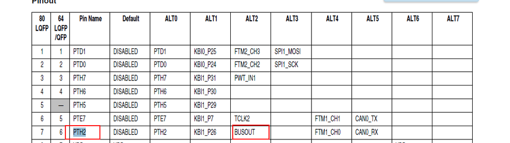

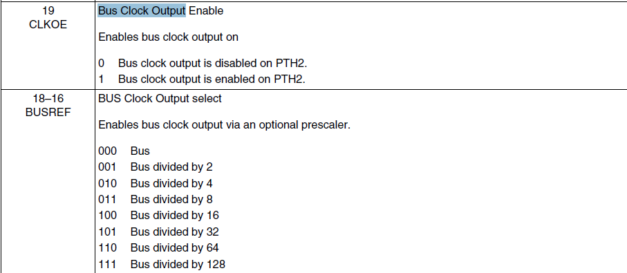

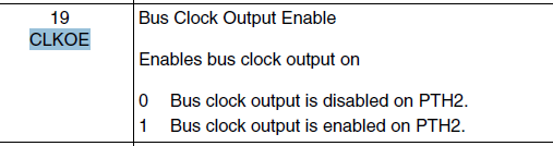

Hello Vignest,
You can check the bus clock on the pin of PTH2 .
First enable the "bus clock output " of this register :
SIM_SOPT0 -> CLKOE
Hope it helps !

But I suggest you use the method which I told you to test the bus clock:
Configure SIM_SOPT0[CLKOE]=1, SIM_SOPT0[BUSFREF]=0, Bus clock output is enabled on PTH2.
This will output bus clock directly!
Wish it helps you!

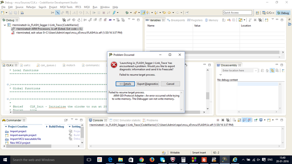

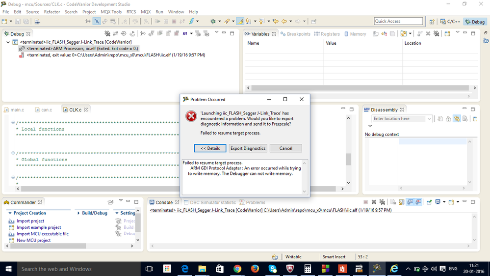

            I am having a problem now.I ran my bus clock at 48 Mhz using the below code change.Now I am not able to flash my code.Can you tell me what went wrong and how to fix it?
SIM_SOPT0 = SIM_SOPT0_CLKOE_MASK;
void Clk_Init()
  ICS_C1|=ICS_C1_IRCLKEN_MASK; /* Enable the internal reference clock*/
  while(!(ICS_S & ICS_S_LOCK_MASK));      /* Wait for PLL lock, now running at 40 MHz (1280 * 31.25Khz) */
  ICS_S |= ICS_S_LOCK_MASK ;       /* Clear Loss of lock sticky bit */
This was the error message I got.I am using segger to Flash the code.Screenshot (11).png
7,139 Views

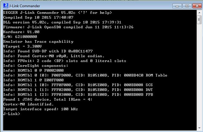

kerryzhou
Hi VIGNESH BALAJI,
    Now please follow me to mass erase your TRK-KEA128 at first, besides, you can't use this code:SIM_SOPT0 = SIM_SOPT0_CLKOE_MASK;, this code is not correct.
   Mass erase the TRK-KEA128 process:
1. install the JLINK driver ​
    After you install the JLINK driver,  you will find the J-Link Commander software.
2. Make sure you are using the JLINK firmware in your TRK-KEA128, from the picture which you give me, I find you already using the JLINK firmware.
The following step is very important!
3, unplug the TRK-KEA128 USB cable in J16, hold on the SW3, don't release the SW3 then plug the USB cable to your PC.
4,don't release the SW3, open J-LINK Commander windows:
You can find the JLINK can find the core now!
5.don't release the SW3, input command in the JLINK Commander windows: unlock kinetis
Waiting the : Timeout while unlocking device   come out
6, release the SW3, input command in the JLINK Commander windows: usb
Until now, your chip is masserased, you can program it again, but take care,modify your code:
to
SIM_SOPT0 |= SIM_SOPT0_CLKOE_MASK;
Because if you use the SIM_SOPT0 =, you will clear bit SWDE, this will disable the SWD debug interface, that's why you can't program agan!
Please follow my step, mass erase your chip at first!
Wish it helps you!
Jingjing
7,139 Views

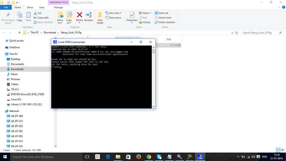

            I am actually getting this message.I explicitly grounded the reset pin for the holding switch instruction.
I am actually using J-Link STR9 Commander.Is that Fine???

vigneshbalaji
Senior Contributor I
Hi Jing,
           It is not detecting KEA-128.I went sent that in settings also both by selecting ARM-M0+ and by Manufactureres list(where I selected as SKEAZ-1284 and tried both security and normal one).
Please combine all the 3 replies from me.

kerryzhou
Hi VIGNESH BALAJI,
   I know if you just connect the board, then use the JLINK COMANDER  you will can't find the core, but did you follow my step?
   Hold on the SW3 before you plug the USB cable, and don't release it, just hold on it all the time before you do the mass erase!
    I already use your code, and use my method do the mass erase a lot of times, each time I can successfully mass erase it, and after you mass erase the chip, you can release the SW3.
  Take care, hold on the SW3 before your board is power on, and keep on holding it after you power on and before you successfully mass erased it.
Wish it helps you!
Jingjing

kerryzhou
Hi VIGNESH BALAJI,
I have not used J-LINK STR9 Commander before, I am not sure whether it works on the kinetis.
  I suggest you install the JLINK driver which I suggest before, then you will find the JLINK COMMANDER
Wish it helps you!
Jingjing

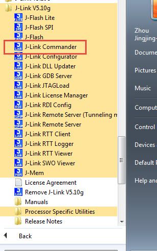

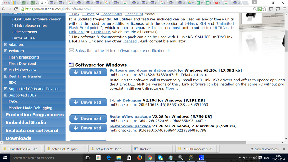

vigneshbalaji
Hi Jing,
            In the J-link Driver Link you gave me.I downloaded the Software and Documentation pack.In that I found only J-link STR commander under version 5.10.
Your version shows 5.02 .Should I go back to the older version If so where Can I find them I am trying Hard to Find them.Can you please chaeck out whether the package I downloaded is right?
7,139 Views

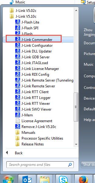

kerryzhou
See my V5.10g install information:
I still can see the JLINK Commander tool!
Jingjing
7,139 Views
kerryzhou
My version is 5.10c, not 5.02, you see the wrong item.
I will try version 5.10g, please wait a moment!
Jingjing
7,141 Views
Hello VIGNESH,
- How about your code to toggling the GPIO pin ?
- About the bus clock output , please refer to the KEA128RM, the PTH2 pin is the bus clock pin,
and configure the "CLOKOE" and "BUSREF" to select the value of the pth2 pin out put.
Hope it helps
Alice Yang
