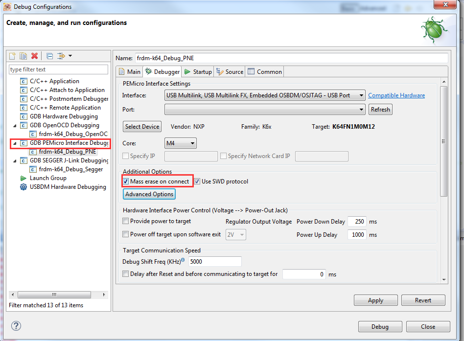

Hello everyone,
I am using FRDM-K64F.
I try to run demo application in debug mode, but  it doesn't run and shows following message in console window:

  Info : IDCODE 0x2ba01477
  Error: Cannot access device, device is secured
  Info : Mass erasing a device will unsecure it until the next reset. To permanently unsecure, mass erase then flash a program containing an appropriate flash configuration field.

Hello Richard,
You can use the PE interface to flash ,  enable "Mass erase on connect", it can unsecured when connect:
First update the bootloader use the firmware "DEBUG-FRDM-K64F_Pemicro_v108a_for_OpenSDA_v2.0.bin",
I attached it .
Alice
5,473 Views
richardlegault
Thank You Alice
This worked perfectly for me.
