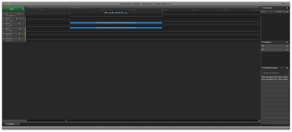

I have a FRDM-KL03 and a FRDM-K64 and I tried running both as SPI master and I'm seeing the same behavior on both. The CLK line looks weird. See attachments. Good screenshot is when host adapter is acting as master and bad screenshot is when KL03 or K64 is acting as master.
Config on KL03 looks as follows:
C1 has SPIE, SPE, CPOL, MSTR and SSOE bits set.
C2 has SPISWAI and MODFEN bits set.
BR = 0x0;
The error says: "The initial (idle) state of the CLK line does not match the settings".
Any help is appreciated.

"The initial (idle) state of the CLK line does not match the settings" this means that the the protocol settings in the analyzer software are not correct. If you are configuring CPOL = 1 then your are selecting Active-low SPI clock (idles high) please check that the Analyzer settings for the SPI protocol are set to "Clock is high when Inactive CPOL = 1 "
Hope this information can help you.

The setting on the logic analyzer ("Clock is high when Inactive CPOL = 1") matches the one programmed on the K64 SPI (CPOL bit is set) and now I'm able to see correct clock signal and MOSI but the SS line is not asserted (see No_SS.png attachment below).
Actually, it is asserted just for a little bit. See SS_blip.png below which is a zoomed section from where the red dot is in No_SS.png.
Any ideas on what could be the problem here?

What are your SPI configurations specially for the bits that control the SS behavior like the:
SPIx_MCR[PCSSE] that for a standard comunication the value is 0: PCS5/ PCSS is used as the Peripheral Chip Select[5] signal.
SPIx_MCR[PCSIS] to determinate the inactive state of the SS signal.
Also if you slave allow the Continuous mode I recommend to set the SPIx_PUSHR[CONT] signal to Keep PCSn signals asserted between transfers. You can check more information about the CONT bit in the K64 Reference Manual in the section 50.4.4.3 Continuous Selection Format.
I had some problems in the past using the Analyzer without the GND probes, I recommend to connect the GND probes to your hardware.

When I was transmitting before, I was using this:
SPI0_PUSHR = SPI_PUSHR_CONT_MASK | SPI_PUSHR_TXDATA(0x1f);
When I add SPI_PUSHR_PCS_MASK, I can see that the CS line stays low but there's as expected but I still see the red dot and the blip on MOSI line and get the error that says "The initial (idle) state of the CLK line does not match the settings".

mjbcswitzerland
Specialist V
There are various other settings in the SPIx_CTAR register which control the timing of the CS line in relation to the clock/data. I suggest you experiment with these until you understand their effects and you may find that the glitch is occurring due to such things not being co-ordinated correctly.

mjbcswitzerland
Specialist V
Check the SPI driver(s) being used - the K64 has automatic CS control controlled by its FIFO control words.
The KL03 only works in automatic SS output when set up with SSOE in SPIx_C1 and MODFEN is set to 0 in SPIx_C2.

mjbcswitzerland
Specialist V
I would suggest that you have the SPI speed set too high for your logic analyser (only 10MHz) to be able to sample correctly.
Set a lower SPI speed and then it will probably look similar (if the SW is correct).

willx
Thanks Mark.
This helped on the KL03, but not on the K64. I can now see the expected signals on the KL03.
