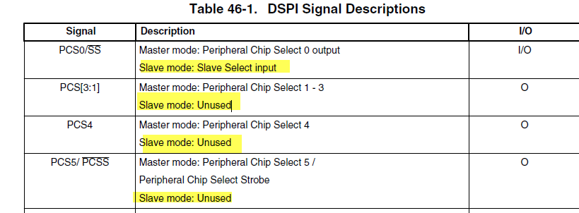

I've got a design with MK20D512 microcontroller, which is supposed to communicate over SPI as slave. According to the user manual, the SPI slave gets activated when the "slave select" ie. PSC[0]/nSS signal is asserted. However, in this case the "slave select" line is not available, and not connected to anything.
Is it possible to manually activate the SPI slave for transfer? For example, can the true "slave select" signal be set or cleared by activating internal pull-up or pull-down resistor (PORTx_PCRn, bits 1 and 0)?

do you mean that I can just mux the pin to function as CS0 pin and activate pull-up or pull-down resistor as needed? I believe I have tried that and this didn't work.

I think we're not talking about the same problem. If I understand correctly, you've explained that to use the SPI slave I should physically connect the CS signal to PCS0, and correctly configure the pin in the PCR register of the port.
However, my problem is that the microcontroller's pin with PCS0 function is not accessible on the board. Thus, I can't connect an external signal to this pin, and I'm looking for an option to drive the PCS0 signal from within the microcontroller - if that's possible at all.
I tried to use the internal pull-up and pull-down resistors of the microcontroller's pin, but it seems that the pull-up and pull-down are ignored if the pin is muxed to PCS. Is this so?

a_r_f_
it's MK20DN512ZVMD10 and SPI1. The problem has been already mitigated, but, for future applications, I would really like to know if such solution with microcontroller triggering its own "slave select" is possible.

kerryzhou
Hi Adam Rudziński,
    Thank you for your updated information, MK20DN512ZVMD10  is the 144 MAPBGA, so you didn't fan out the SPI1_PCS0 pin, is it right? It is really a problem, as you know, to SPI slave, the PCS pin is the input pin to select the chip. and when it is the slave pin, you just can use PCS0 as the slave select input pin:
You can try to internally pull down, the internal pull up and pull down is used as the input pin.
 But, in my opinion, if it is the application, it's better to modify the hardware, and fan out the PCS0 pin, and connect it to your master PCS pin physically .
