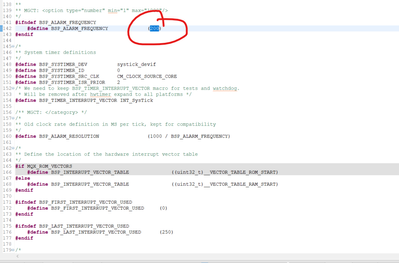

my finding was i was exceeding allocated time for this task. if i give delay after every SPI command, i am good.
what is good way yo increase allocated time to task, do we have any example.
i have read from Forum, they are saying to change this number. i did but not able to increase task allocated time.
1) i want to set 100ms time to this task. there are so many things in this task. what is the way
