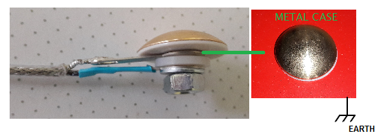

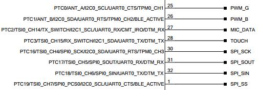

On a MKW30Z requiring one pin for capacitive touch TSI sensing circuit PTC3 muxed to TSI0_CH15
The TSI plate is not mounted on PCB, but via a small coax cable less than 10 cm to a brass metal knob on the metal case isolated from the case.

What I don't like is that you have used the TSI pin neighbouring to the hi-speed SPI_SCK signal. Which can cause some cross-talks.

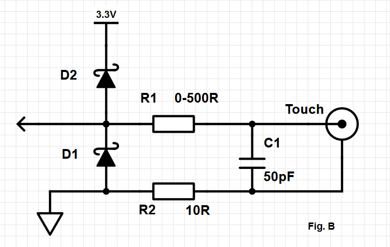

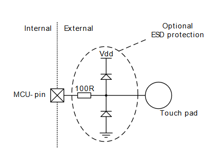

Also about Fig B I see some other references:
AN0040.pdf
A series resistor of 100 Ohm - 1 kOhm
A typical resistor value is 1 kΩ, but the value can range from 100 Ω to 10 kΩ

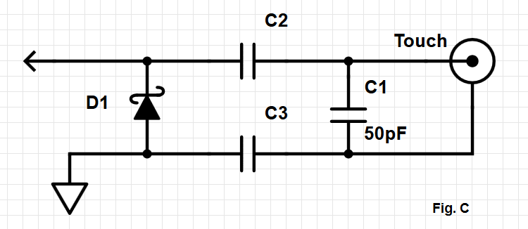

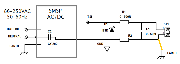

On my layout I can cope with a few topologies like:  Fig A  (R2  0-10R)
Or can add additional protection to Vcc 3.3
Or can I fully decouple DC component from touch button ?

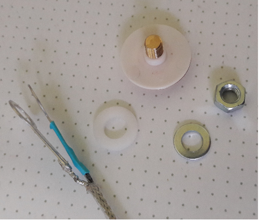

My HW circuit looks like this:
My sensor size is disc 19.45mm diameter; surface 297mm2 - brass.
(~Optimal 15 mm x 15 mm - diagonal 21,213mm; surface 225 mm2)
Sensor traces length to connector 23mm. Coax wire to sensor 150mm.pastedImage_2.png
The sensor is isolated from metal case:
R2 is to protect from earth injection to gnd.
How should the earth be connected ?

Lucian,
I understand how the knob is connected and isolated.
What is not clear for me right now is:
- How is the KW30 MCU supplied, what kind of power supply is used?
- Is there a trafo / capacitive power supply or switching power supply with isolating transformer used?
In other words, is that galvanically isolated from the mains / hot line?

In this app - the MKW30Z is supplied via SMPS AC/DC convertor, there is no battery.
There is galvanic isolation from mains.
There is a 2.2nF Y capacitor for grounds separation ESD flow (AC GND -> 3.3V logic GND)

Hi Michael,
Ok R13 will not be mounted.
R81 should act like a fuse 1R ~ 10R  (protect for external ESD injection)
The environment is quite nosy - did not have any other better choice -
we use all pins of the MKW30Z (has less fewer pins than MKW40Z ...)
Yes the physical electrode size is large made of brass, isolated from metal head.
(like a brass knob)
A coax wire is use between the knob and PCB.
R14 and R18 can changed to capacitors so the knob is decoupled by the circuit ?
Thank you,
Lucian.

Parallel resistor is actually not mounted and was planed as a pad for a parallel capacitor.
