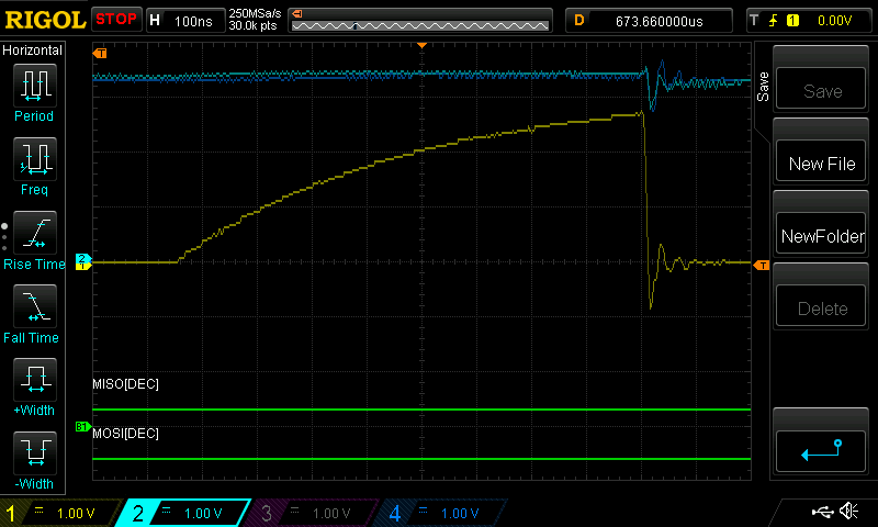

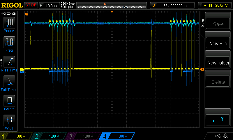

Everything works fine, except a wierd short clock pulse(in yellow- MOSI is dark blue and MISO is light blue) everytime I send a packet before the actual payload:
A closeup of this short pulse:
MOSI sends correct bits and clock works great except the pulse part.
Unfortunatelly this pulse messes up the slave so won't send his data back. Tested this SPI communication with some other chip and it worked fine.
