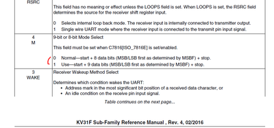

we have to use UART1 with  8N2.  ->  2 stop bits
Maybe i am blind, but i can't find any µC register for that.
Is it true, that the microcontroller doesn't have this feature?
If yes, is there a work arround?
Andreas

Refer to the RM, the uart only supports one stop bit. The data length can be 8 or 9. So you are right. We do not have 2 stop bit feature.
