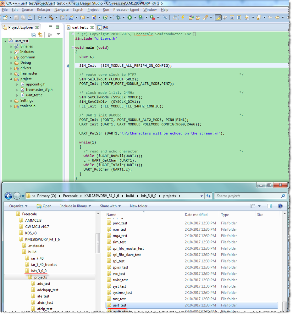

Robin_Shen
Hi Druv,
Have you try to test the example using KDS?
I test the uart_test example on TWR-KM34Z50MV3 board using KDS and IAR.
It doesn't work when using IAR.
I download the KM128SWDRV_R4_1_6 from Kinetis M bare-metal drivers and software examples released - REV 4.1.6.
Robin
