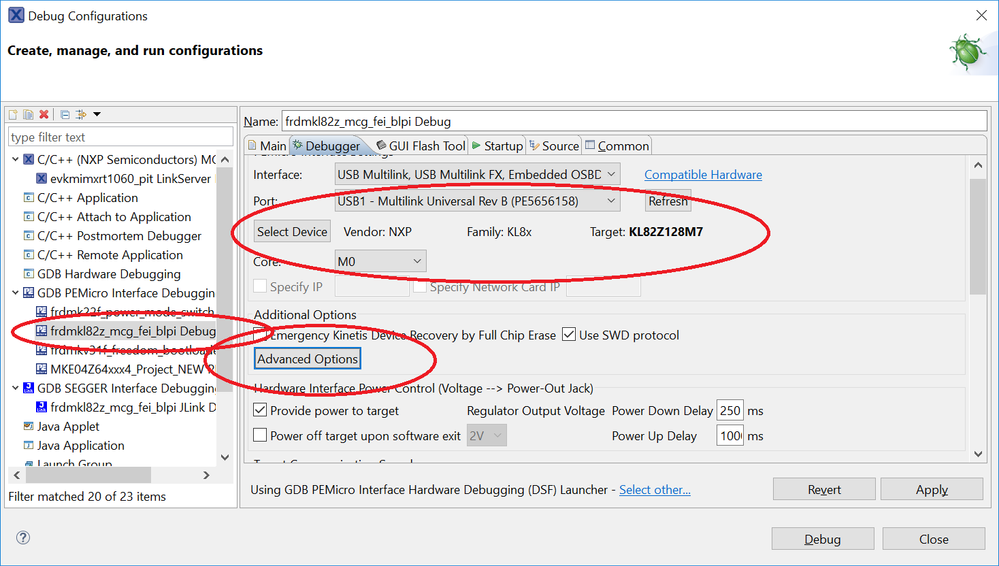

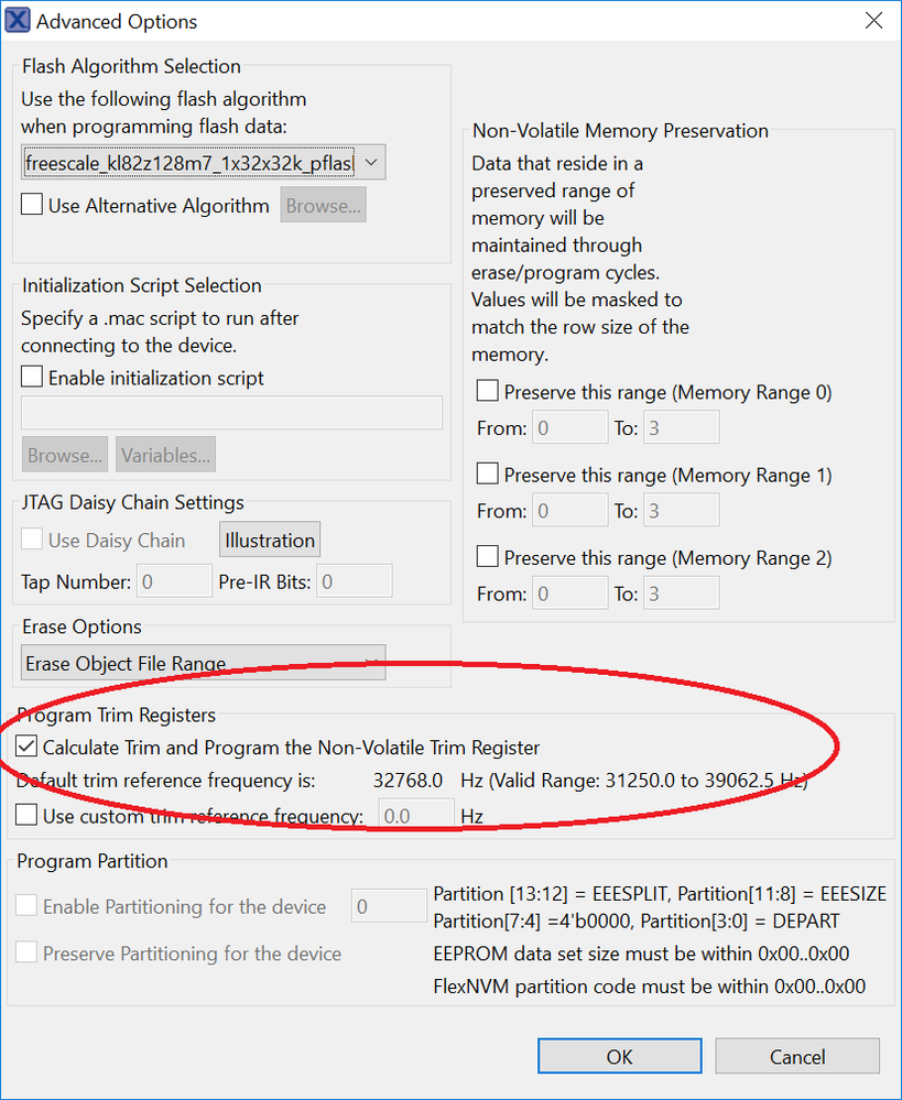

But there is no word say where is this value location in IFR. I can see in other Kinetis K series device that it's 0x3FF(SCTRIM) and 0x3FE(SCFTRIM). Maybe you can try to use Program Once command to program trim value into this space. But I really don't know if it works.
Another way is use MCUXpresso and P&E as debugger. P&E has additional function to trim 32768 internal osc.
The last option is trim by yourself. Then record the value in your code. After reset, you can write this value into register.
