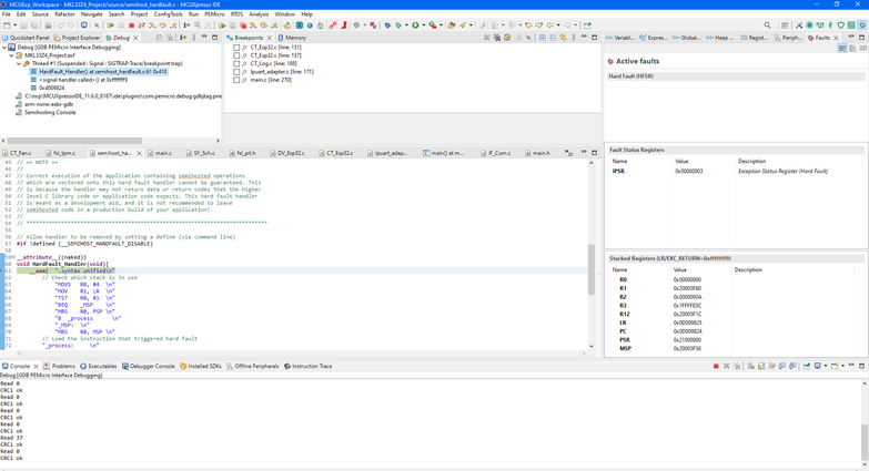

Hello
I'm on a custom board with a Kinetis MKL33Z256.
This board use many UART.
The UART0 is used to communciate with a Wifi module (ESP32) through AT command on serial port.
For now, I start to devellop without activate the ESP32 then no characters was received/sent on the UART0.
All is Ok, the project is configured on "SDK Debug Console -> Semihost console" then when I made printf on the C code, I see the text into in the MCUXpresso console.
My question is how this work with Serial UART0?
Because since I activatet the ESP32 module, I send and received character on the UART0, but I get an Hard fault:
I suspect there is a conflict between the UART 0 used and the console.
I do not know exactly how work the "debug console" and the interaction with UART0??
This is my UART config
Is somebody can help me?

arnogir
Senior Contributor II
Hello
Sorry for the long reply, I was locked on this site and I must make verify my e-mail. This is ok now!
I found my mistake.
Into the UART interrupt callback, I call again HAL_UartReceiveNonBlocking to read the next byte.
But I changed by mistake the pointer on a global variable buffer to a local buffer (into the stack)... This is why, when data received, it was written into this stack at a time where this address was used for other thing...
Sorry for that.
But with semihost, I make a printf to the console(in ground loop) of the received data on the UART0.
But Semihost should have prior interrupt than UART0? Because some data are missed sometime from the real received data..
Without printf, all run correctly.
