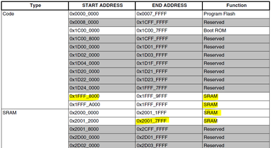

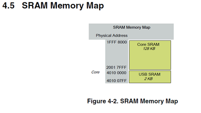

The SRAM layout in the KL28 is the same as in all other L parts:
1/4 anchored below 0x20000000
3/4 anchored above 0x20000000
In the manual it is show in two places:
although it is a strange that in the first table the first 1/4 of the SRAM is in the code section rather than in the SRAM section.
Mark

ErichStyger
Specialist I
So either the SDK or the RM is wrong, I believe the later (or at least misleading).
