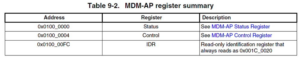

mikestevens53
Actually, the Command Windows pictures claims that it did the mass erase, but also notes that there was an issue with “0x1C0020 is not correct”. Also functionality is still not working.
I borrowed a J-Link from a local NXP support person, used the command line utility to do a unlock Kinetis + erase, and that allowed the part to start working again.
Mike Stevens
4,554 Views
jorge_a_vazquez
Hi Mike Stevens
Glad to hear that your part is working again. There shouldn't be problem with the IDR as 0x1C0020 because Kinetis-K series has ID:0x001C0000 and Kinetis(L/M/V/E) series have ID:0x001C0020 on MDM-AP IDR register:
Although, I will check this in the SigFlashCmd.exe for further information.
