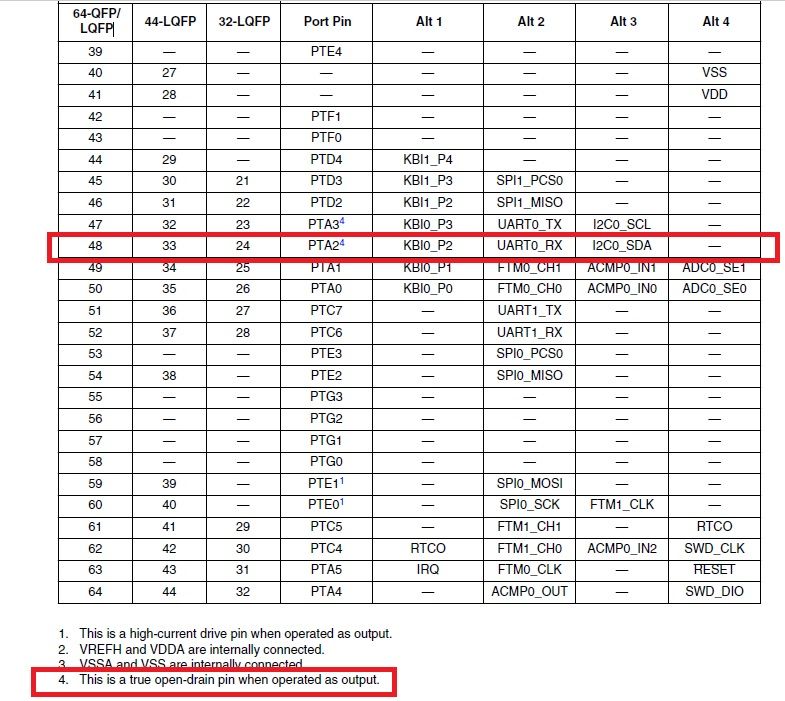

btruden
Hi Jun-Young Lee,
how are you?
Have you solved this problem?? I've just got stuck on this same issue.
I try to configure PTA2 as a simple output but nothig occurs, when I try to set it to "1" there's no change on the pin voltage.

btruden
Hi Mark,
I've finally found the problem. In this MCU the PTA2 pin, when configured as output, is open drain (below an extract from the datasheet):
So I have to place an external pullup resistor.
Thank you for your time.
Best regards!
7,369 Views
mjbcswitzerland
Specialist V
Blas
If you had mentioned you were using a KE part and not the KE02 as in the thread I could have immediately told you than.
In the case of the KL02 there is also the same true-open-drain pins, but on PTB3 and PTB4 instead.
Mark
