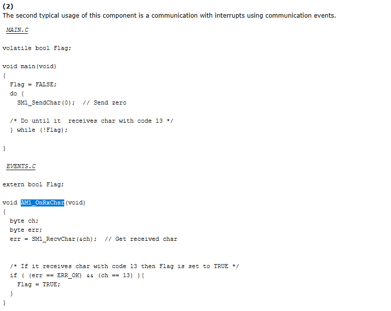

There is no problem with SPI transmission. How do you judge the end of the transmission according to the routine? The situation I encountered is this: always in the first send does not end
2,157 Views
Robin_Shen
Hi bincheng,

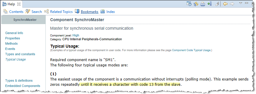

About the typical usage, have you try to use another SPI send char 13?
This example sends zeros repeatedly until it receives a character with code 13 from the slave.
Robin

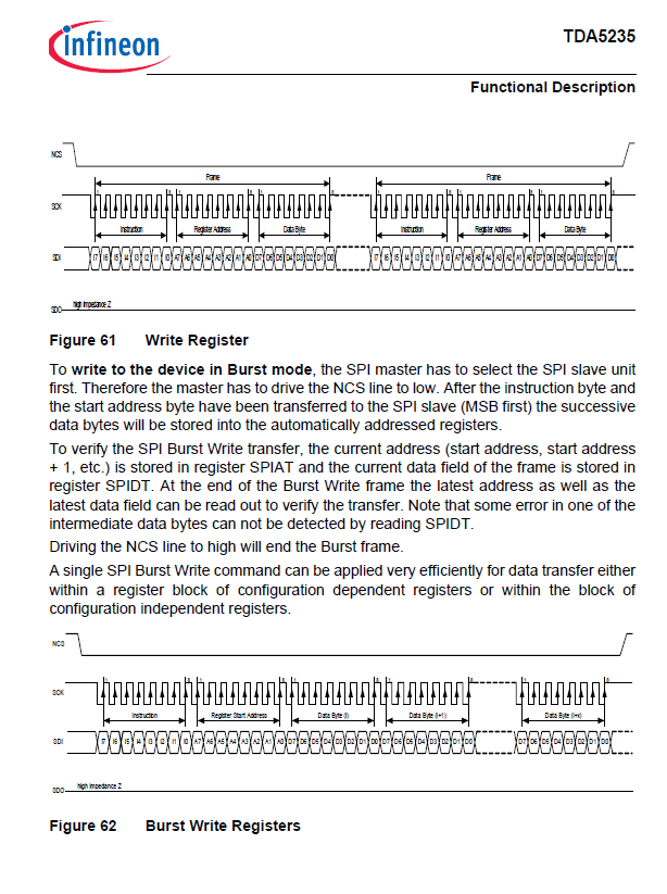

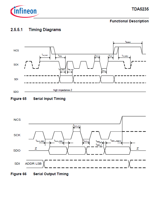

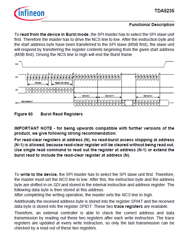

How to set the acceptance of SPI communication is valid on the second edge of the clock detection?Never get a response after sending a message。The picture is the communication requirement of the SPI slave. Please help to configure the SPI configuration of the MKE06 chip.

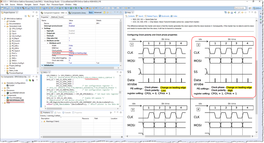

Maybe you need to reconfigure the SPI clock format shown below:
