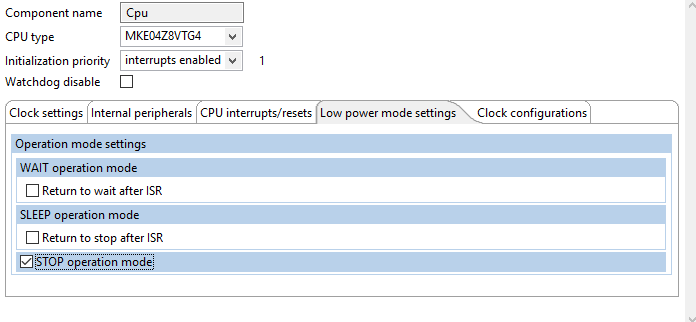

I'm trying to make the MKE04Z8 enter STOP mode. I'm working with MCUXpresso IDE and I am not able to find the register to toggle to make the cpu enter stop mode when the WFI rutine is called. In the manual reference stop mode is only mentioned to explain functionalities and not how to really implement it.
In KDS there was an option on processor expert:

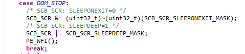

And then the code generated was the following:
This SCB_SCR des not exist in MCUXpresso nor it's mentioned on the manual reference. If I dont activate this deepsleep bit the __WFI(); rutine, it just puts my microcontroler in wait mode and that's not acceptable in my case, for consumption reasons.
I would like to know how to implement the STOP mode, using the clock tool in MCUXpresso or directly with baremetal.

  About the SCB register, you need to find it in the ARM cortexM0+ core document, not the KE04 reference manual.
  About the ARM core document, you can go to the ARM official website to find it.
  The register code, normally, you can find it in the core_cm0plus.h, I already attach it.

The stop mode code is:
void stop (void)
 /* Set the SLEEPDEEP bit to enable deep sleep mode (STOP) */
 SCB->SCR |= SCB_SCR_SLEEPDEEP_Msk;
 /* WFI instruction will start entry into STOP mode */
#ifndef KEIL
        // If not using KEIL's uVision use the standard assembly command
 asm("WFI");
#else
        // If using KEIL's uVision, use the CMSIS intrinsic
 __wfi();
#endif
void PMC_SetMode(PMC_Type *pPMC,uint8_t u8PmcMode)
    switch(u8PmcMode & 0x3)
        case PmcModeRun:
            break;
        case PmcModeWait:
            wait();
            break;
        case PmcModeStop4:
            /* enable LVD in stop mode */
            pPMC->SPMSC1 |= (PMC_SPMSC1_LVDE_MASK | PMC_SPMSC1_LVDSE_MASK);
            stop();
            break;
        case PmcModeStop3:
            /* disable LVD in stop mode */
            pPMC->SPMSC1 &= ~(PMC_SPMSC1_LVDE_MASK | PMC_SPMSC1_LVDRE_MASK | PMC_SPMSC1_LVDSE_MASK);
            stop();
            break;
        default:
            break;
You can add the baremetal code to your MCUXpresso project.

Thanks for your fast response, now all makes more sense.
From 4mA to 0.2mA =).
