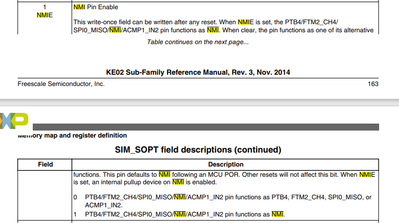

Hello All,
The BIT description for the FOPT Register is not found in the KE02 Sub-Family Reference Manual .
How can one disable the NMI option at power up?
I have already disabled it in the  SIM->SOPT register, but the  NMI still fires  at Power UP intermittently.
There is a 4.7K Pull UP on the  Pin along with a 47nF capacitor.

   To KE0x chip, the NMI can't be disabled during POR. It just can be disabled in SIM->SOPT register, and this register control just can be done in the code.
    So, in the POR phase, your NMI pin is still the NMI function, that means, you need to make sure the external NMI pin input signal is high, otherwise, it will influence your MCU boot.

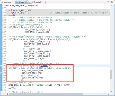

Hi @satbir7 ,
what I usually do in such situations is checking the code in Processor Expert.
See https://mcuoneclipse.com/2014/04/18/pin-muxing-using-the-nmi-pin-as-gpio-pin/
KE02 is supported (e.g. in Kinetis Design Studio): there is a setting to disable the NMI:
It seems that indeed this does not change the NV_FOPT and the bits remain all 1:
But what it does it changes the SIM_SOPT:
Because I don't have a KE device I'm not able to test it. I have attached the project I have generated with Processor Expert for you.

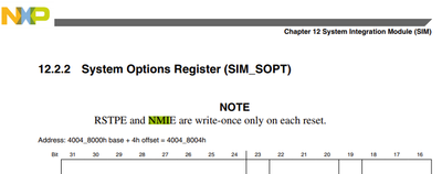

Hi @satbir7 ,
indeed, the FOPT description is very minimal:
taken from the RM here:
https://www.nxp.com/products/processors-and-microcontrollers/arm-microcontrollers/general-purpose-mc...
If it follows other Kinetis devices (not sure), then it is a mirror of the SIM_SOPT:
I don't have a KE, but for all the Kinetis devices I use I have to configure and store the FOPT in the boot/flash configuration configuration area, see https://mcuoneclipse.com/2020/06/09/disabling-nmi-non-maskable-interrupt-pin/
