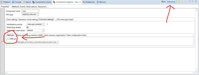

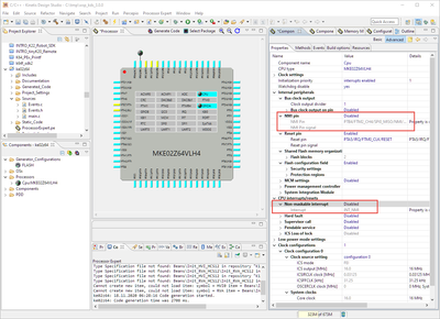

ErichStyger
Specialist I
Hi @satbir7 ,
what I usually do in such situations is checking the code in Processor Expert.
See https://mcuoneclipse.com/2014/04/18/pin-muxing-using-the-nmi-pin-as-gpio-pin/
KE02 is supported (e.g. in Kinetis Design Studio): there is a setting to disable the NMI:
It seems that indeed this does not change the NV_FOPT and the bits remain all 1:
But what it does it changes the SIM_SOPT:
Because I don't have a KE device I'm not able to test it. I have attached the project I have generated with Processor Expert for you.
I hope this helps,
Erich

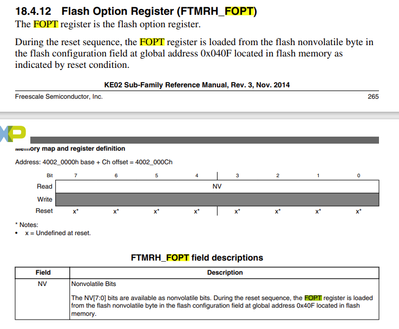

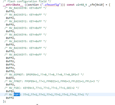

ErichStyger
Specialist I
Hi @satbir7 ,
indeed, the FOPT description is very minimal:
taken from the RM here:
https://www.nxp.com/products/processors-and-microcontrollers/arm-microcontrollers/general-purpose-mc...
If it follows other Kinetis devices (not sure), then it is a mirror of the SIM_SOPT:
I don't have a KE, but for all the Kinetis devices I use I have to configure and store the FOPT in the boot/flash configuration configuration area, see https://mcuoneclipse.com/2020/06/09/disabling-nmi-non-maskable-interrupt-pin/
I hope this helps,
Erich
