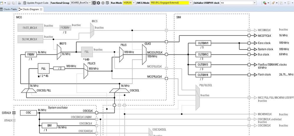

I try to configure the clock for an MK66 180Mhz, using the Config tool with Clocks Table and Clocks Diagram, but I do not understand how to do it, I have tried several combinations and values and they always give me error.
Could someone explain how to configure it for an MK66 at 180Mhz?

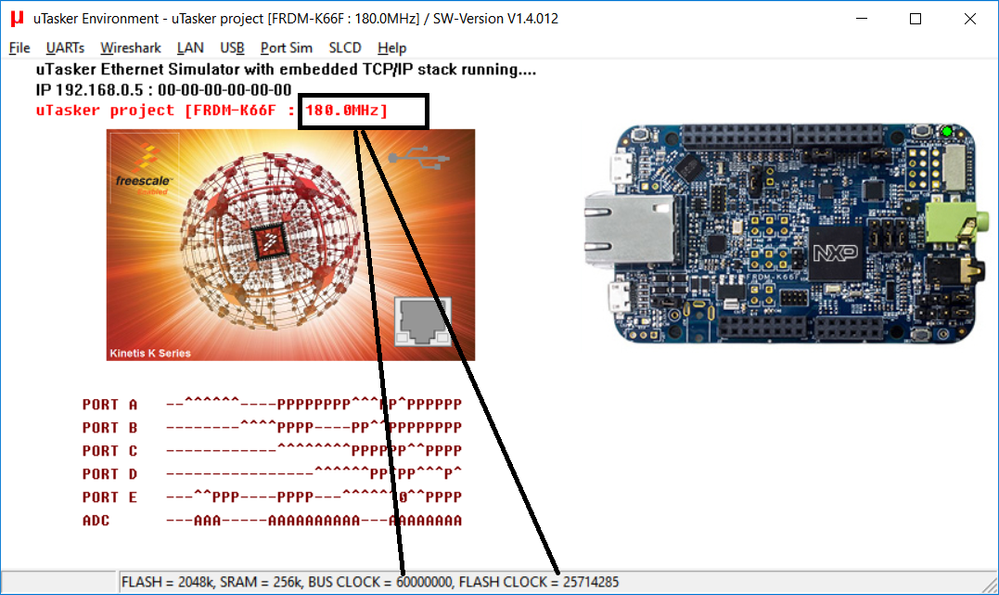

Assuming 12MHz crystal the following are the actual values that it uses:
12MHz crystal, 180MHz core clock, 60MHz bus, 25.714285MHz flash

Beware that for 180MHz core clock you must use the HSRUN mode, which means that flash programming is not possibel without first reducing clock speeds and switching to RUN mode (see the user's manual for the compete list of HSRUN mode restrictions).

Thanks mark.
My problem was that the configuration was in RUN mode, so the frequency of the Core could not be higher than 120Mhz.
After select HSRUN, now everything is fine, I can configure the clock with Config Tool at 180 Mhz, with div at /2 and PLL at *45, for a crystal of 16Mhz.

Yes, I thought that maybe there may be something with setting HSRUN in order to get the higher speeds.
And /2 and *45 is the only combination possible to get 180MHz from 16MHz crystal.
