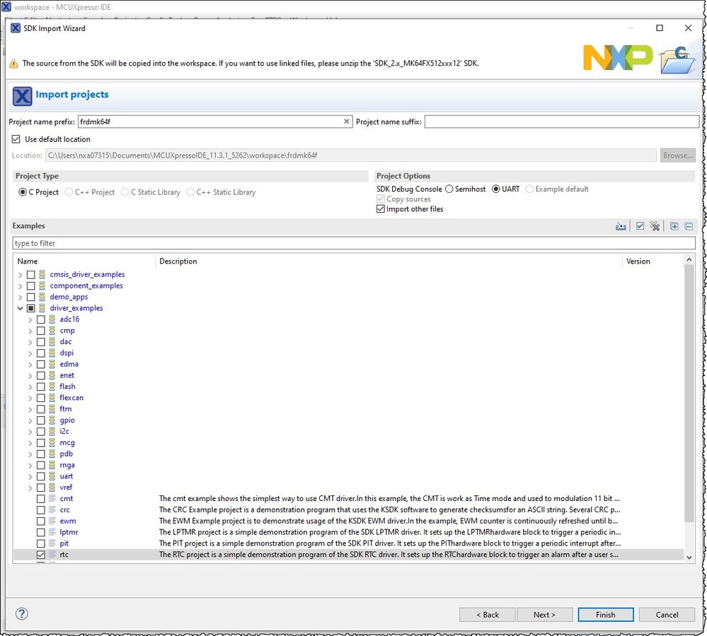

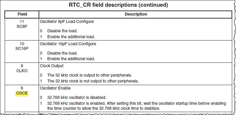

Did you enable the RTC_CR[OSCE]?
You can refer the rtc example in SDK_2.9.0_MK64FX512xxx12.

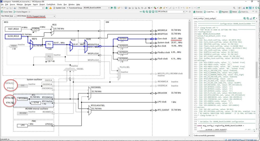

Please check if XTAL32 and EXTAL32 are well connect to the external 32768KHZ crystal. No external load capacitors or bias resistor is required as these are supplied internally.

I did
RTC_DRV_Init(0);
RTC->CR |= RTC_CR_OSCE_MASK; // Enable Oscillator
Not working yet.

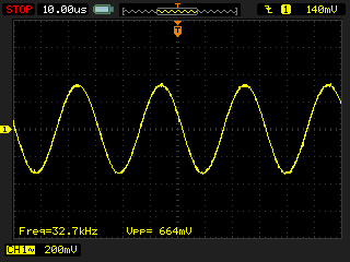

Would you please measure if the external 32768KHZ crystal is well solder.(Using a multimeter to measure whether the pins of the MCU and the pins of the external crystal are connected)
In order to not use external 50MHz reference clock(for your convenience when testing) I modify frdmk64f_rtc example.
Please try to test the attached example.
You should be able to see the waveform at the pins of crystal.(using oscilloscope with 10X probe )

Oliveira
Hi Robin,
I can´t measure the wave form but I´ve changed the project to toggle a LED and uploaded the axf file to the board.
It´s working now, I don´t exacly know what was wrong but I am going to further study the code to try to grasp it.
