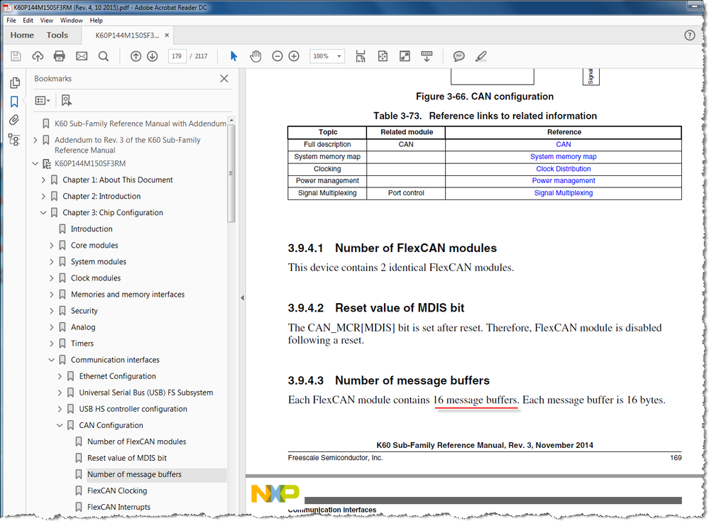

hello,everyone:
    In the chip "MK60FN1M0VLQ12", how many buffers the CAN module is? The datasheet don't tell.16 or 32?
1,711 Views
Robin_Shen
Hi Minmin,
Each FlexCAN module contains 16 message buffers. Each message buffer is 16 bytes.
You can find this information from it's Reference Manual K60P144M150SF3RM.
