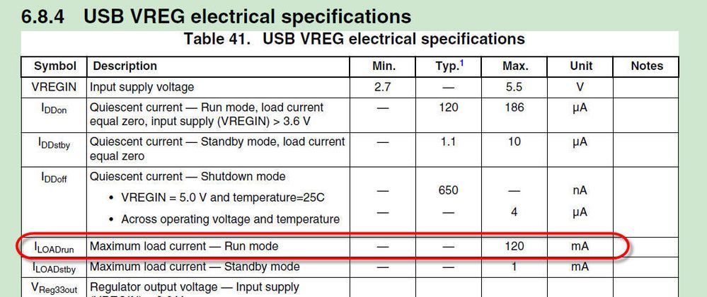

MK60 MCU has a "VREGIN" pin which can be connected with USB VBUS, then get power at pin VOUT33,
my question is how much current can the "VOUT33" supply?
1,177 Views
Hui_Ma
MK60 datasheet with related info, the Max. load current is 120mA.
Wish it helps.
