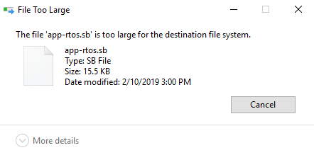

I have my Bootloader running on the MK22FN512 so that Applications can be drag and dropped on to address 0xA000 in Flash. This is working and I have three *.sb files created. One was good old Blink LED Demo, the second was a console LPUART application I created, and now the third is a small FreeRTOS application that has a couple tasks and a queue sending keypad inputs across the Queue.
When I drag and drop the latest application, Windows kicks back an error but everything appears to work. My RTOS keypad application was installed on the K22 and looks fine. Anyone else run into this error? The file is only 15.5 KB
1,912 Views
gsinde
I think I made have my address set incorrectly to zero (which causes a lot of weird behavior) since it is supposed to be at 0xA000. I will keep watching this but it looks like I am not seeing this error message today.
