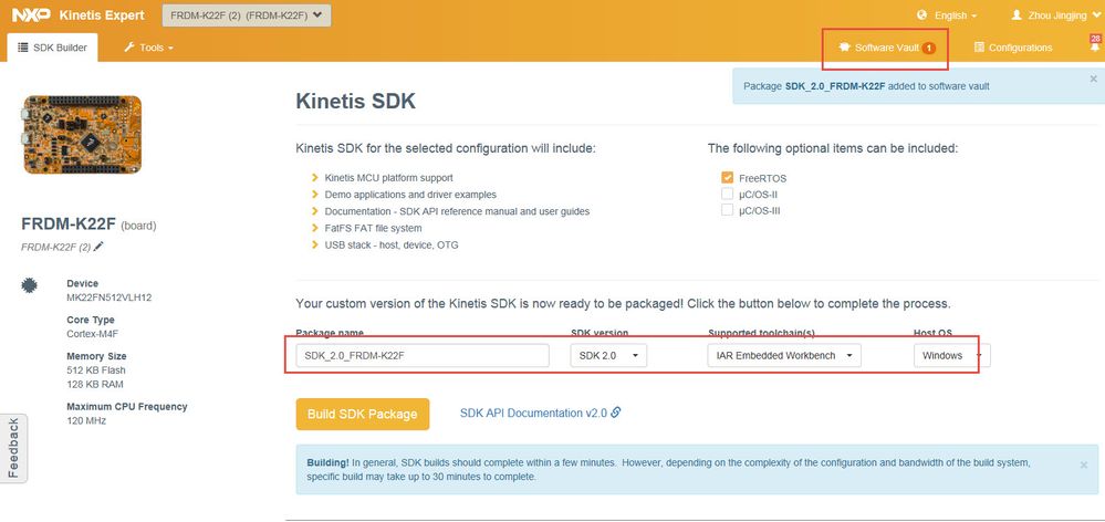

geison_mancuzo
Thank you so much for your answer, but dont find examples do not know how do.

kerryzhou
Hi Geison,
    Go to this link, and login:
Welcome to Kinetis Expert | Kinetis Expert
click Build an SDK, choose boards, FRDM-K22, then build SDK package:
click software vaults, and download the SDK_2.0_frdm-k22f, you will find the flash sample code in folder:SDK_2.0_FRDM-K22F\boards\frdmk22f\driver_examples\flash\flash_erase_program_verify
Wish it helps you!
