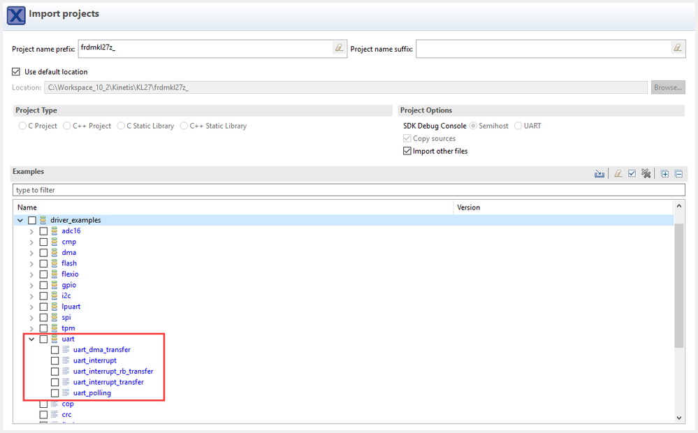

Hello Mike,
You can download the MCUXpresso SDK for the FRDM-KL27. The MCUXpresso SDK is a comprehensive software enablement package designed to simplify and accelerate application development with NXP’s LPC and Kinetis microcontrollers and i.MX RT crossover processors based on Arm Cortex-M cores. The MCUXpresso SDK includes production-grade software with integrated RTOS (optional), integrated stacks and middleware, reference software, and more.
Within the SDK you will find the drivers for the lpuart along with examples that show how to implement these drivers.
Hope it helps!
Victor.

Hello Mike,
I recommend you to migrate to our newest software (MCUXpresso SDK) and IDE (MUCUXpresso IDE) that are fully supported and continuously upgrade. Within the SDK you will find examples of both UART and LPUART peripherals. You can use these examples to see the easiest way to set up LPUART Rx.
Victor.
