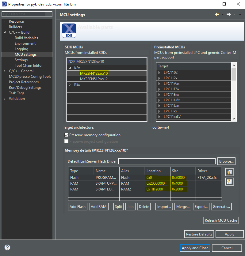

I'm struggling with USB vcom example for quite a lot of time, it worked me when i used exactly the same chip as on FRDM-K22F board which is MK22FN512VLH12, but i decided to switch to little cheaper microcontroller to save some money but example is no longer working.
I did some changes in example to run on my custom boards(using internal clocks) and it  works just fine on my custom board with MK22FN512 but when i load it to MK22FN128 it no longer works :smileysad:. Could u please point me in the right direction or tell me another solution how to add simple vcom to my application?
Also this driver takes 18Kb of RAM  and MK22FN128 got 24kb but it's split into 16kb and 8kb so probably i need to change some things to make this work?
I setup memory as shown above but it ends up with an error:

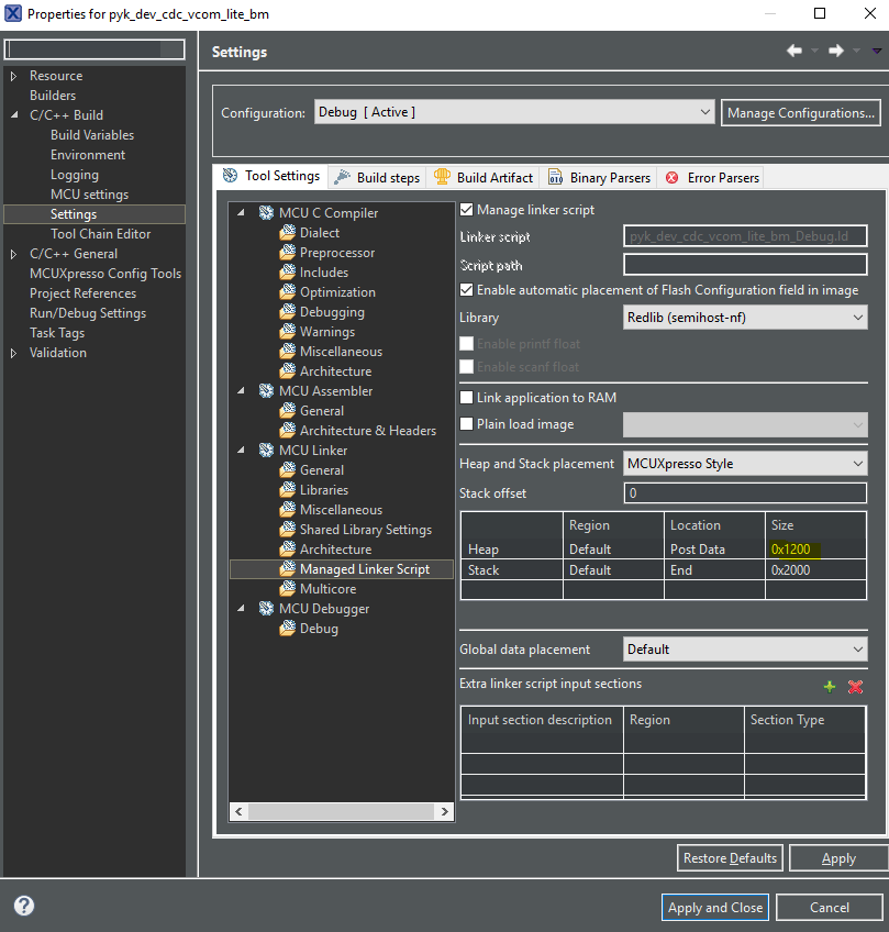

Is it safe to reduce heapsize from 0x2000 to 0x1200 using this application or it will cause problems?

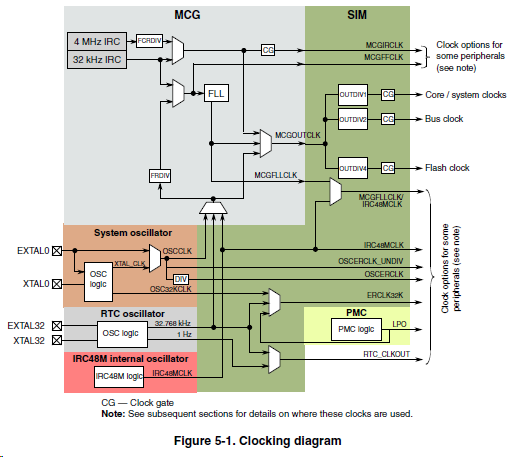

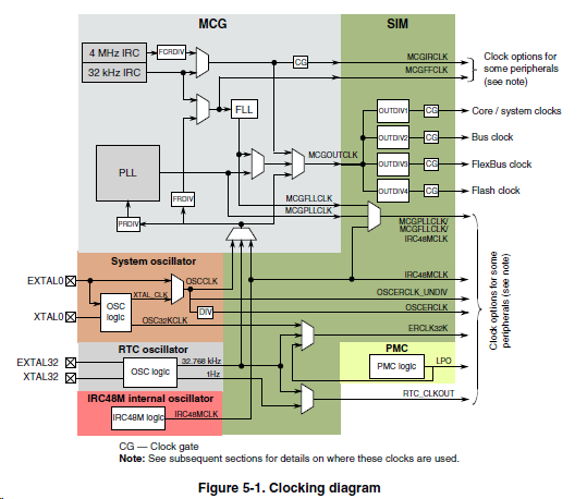

Unfortunately I don't think that you have the experience to be able to use the uTasker code in our project so you may  need to debug and adapt the example that you have from the K22FN512. You already know that it doesn't run on the K22FN128 so you need to investigate why not and what needs to be changed.
Initially you need to start with an analysis of the clock configuration since it sounds as though the FRDM-K22F example is using the PLL, which doesn't exist in the K22FN128:
Top is from K22FN512 - bottom is from K22FN128 (note the absence of the PLL).
You can also try to configure the original FRDM-K22F project to use the IRC48M (crystal-less) because then the clocking would already be the same and then moving to the K22FN128 will be a smaller step.

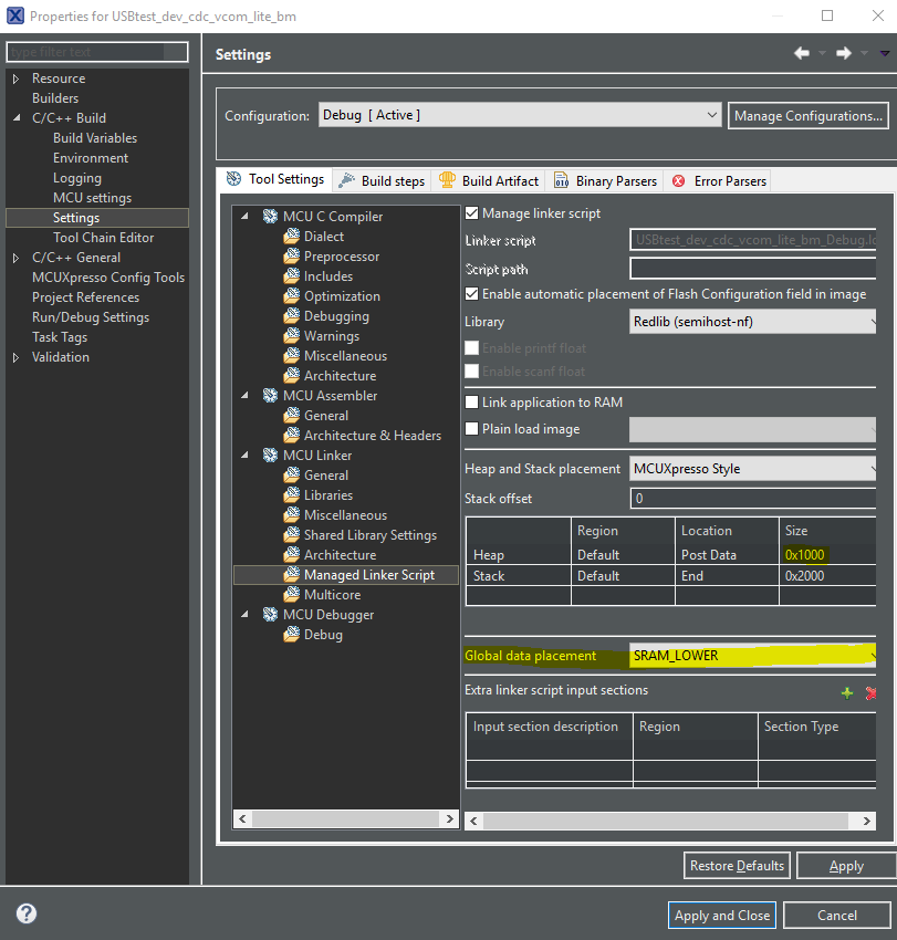

There is only one last problem, example takes more than 16kb or ram, which actually will overflow SRAM_upper. Temporary solution was to change heapsize and change global data placement which allowed me to compile and flash. I'm not sure if it's good solution or it will have consequences eventually.

I don't know details about the examples use of memory so it is wise to analyse what it is using it for and how to dimension it to suit your own needs. Using examples blindly for real project work (when you know that the memory is somewhat restricted) is never a good idea so this is an investment that is necessary for serious work to avoid risks and potential product failure later.
