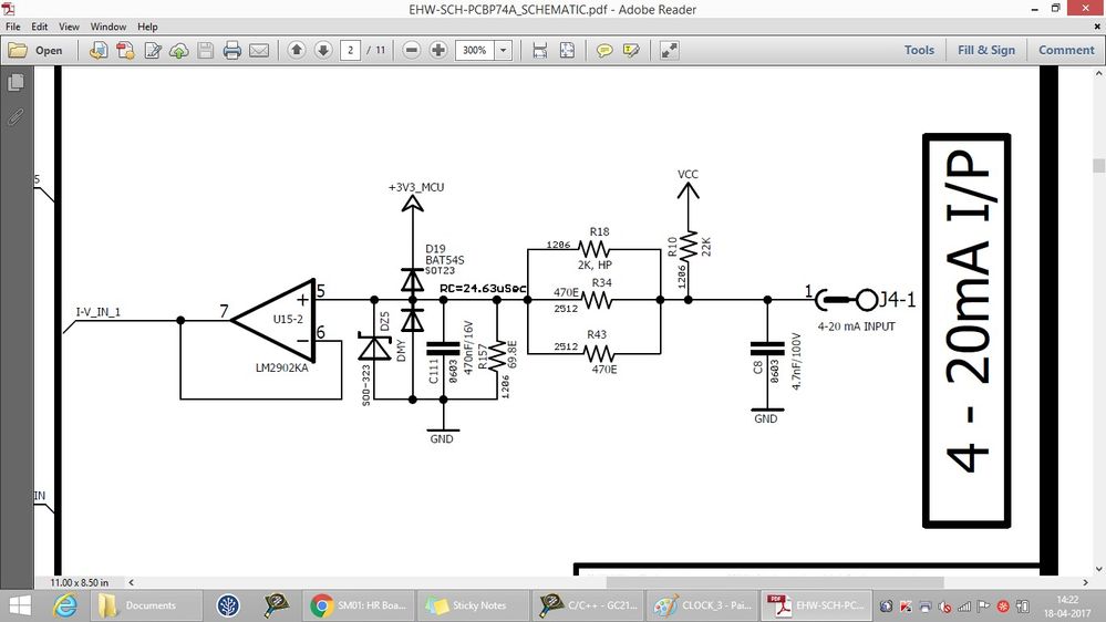

tejasgawade
Dear Xiangjun Rong,
   Thanks for reply. Please refer below image for opamp signal conditioning.
   Impedance value is not specified in opamp datasheet but generally it should be 50 to 200 ohm.
   Please note that same circuit works fine with other adc channels, which is strange.
   Initially i also thought its sample time issue and tried to increase it but no success. but when i increased over all conversion time (>7us) it started to give correct count.
   I suspect issue is with adc clock frequency & specific adc channel port structure.
Tejas

xiangjun_rong
Hi, Tejas,
From the schematics of ADC part, I think it is okay from analog conditional part, the OP AMP output impedance is low, it is okay.
I think the ADC clock has impact on the ADC accuracy, Maybe the ADC clock is not proper, pls refer to the 6.6.1.2 16-bit ADC electrical characteristics in data sheet for the ADC clock frequency.
Hope it can help you
