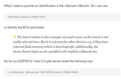

I read your blog, then added K20 and was able to query it successfully.
But as I read this,
I have some doubts:
I don't know what 'implicit wildcards' is.My device is MK20DX128VFM5 and my board is Analog Devices' EVAL-ADICUP3029, so how exactly should I enter instructions when entering?
9,432 Views
ErichStyger
Specialist I
What matters in this case is the device, not the board.
The board would be only relevant if you have external RAM or FLASH, as that would be board specific.
Implicit wildcards means that you did not specify the full device/board tuple.

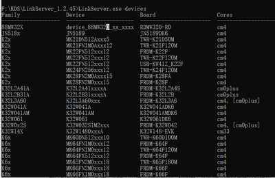

zhaofan123
I just installed the LinkServer command line utility and tried to follow your blog to use it. But when I enter the command shown in the figure below, the computer shows the supported devices as I thought, and I can't query any information about the K20.
9,598 Views
ErichStyger
Specialist I
As a consideration, have you thought about adding the K20 to the list of devices for LinkServer?
9,586 Views
zhaofan123
I hope to add K20, but I don't know how to do so. It would be great if I could get your help.Also, I would like to confirm one thing, is it not possible to burn. HEX files using KDS?
