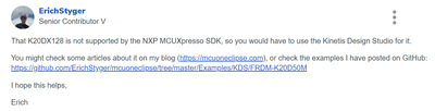

That K20DX128 is not supported by the NXP MCUXpresso SDK, so you would have to use the Kinetis Design Studio for it.
You might check some articles about it on my blog (https://mcuoneclipse.com), or check the examples I have posted on GitHub: https://github.com/ErichStyger/mcuoneclipse/tree/master/Examples/KDS/FRDM-K20D50M
I hope this helps,
Erich

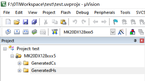

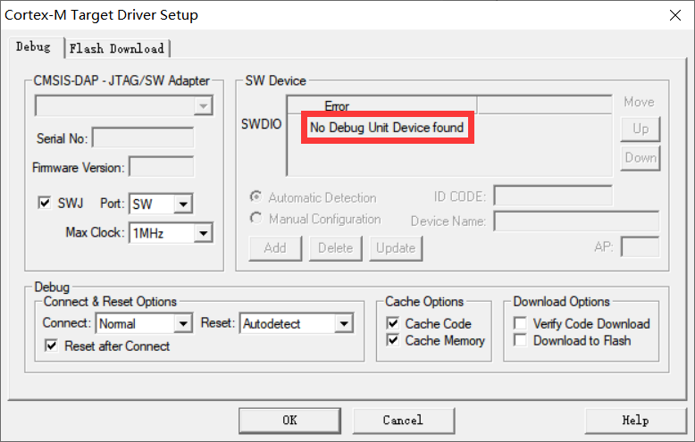

I've read a lot about it lately, including your blog, but I still don't know.
I use KDS and Keil together based on your blog. Finally, a .uvprojx file was generated in KDS and successfully opened in Keil.
But when I set it up, I can't find the device.
I've installed all kinds of software, but I still don't know how to program an empty chip. Would love to get your help very much, any response from you will improve the efficiency of my learning.
Also, I would like to state to you that I am unable to download the program in GitHub and that the program you posted appears to be for IAR use. Is this correct?

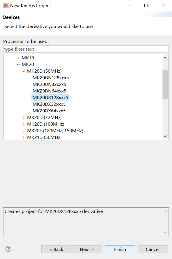

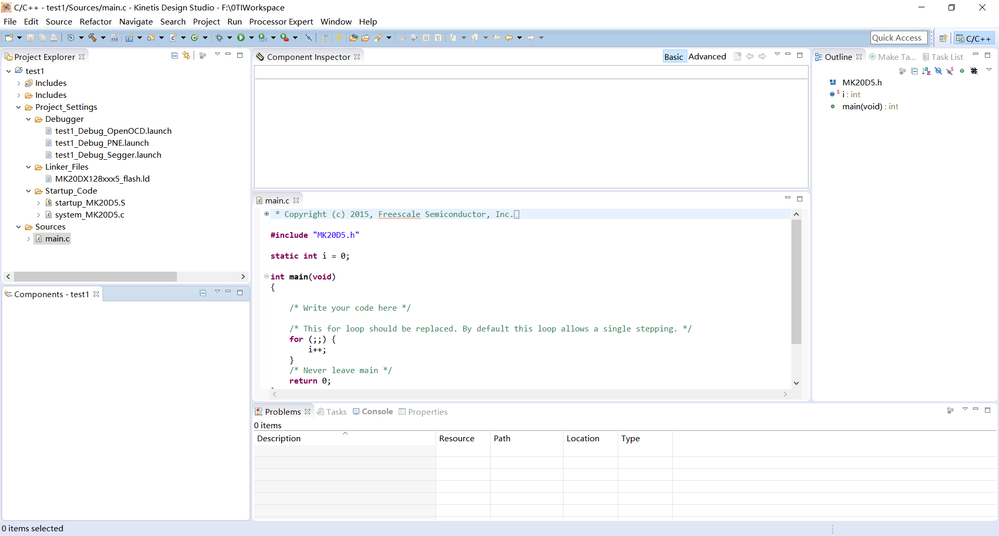

Glad to hear from you. As shown in the figure below, I am trying to use KDS now, when I create a new project and match my target chip, what should I continue to do?
Can you please tell me what to do next, or give me some links to learn?
