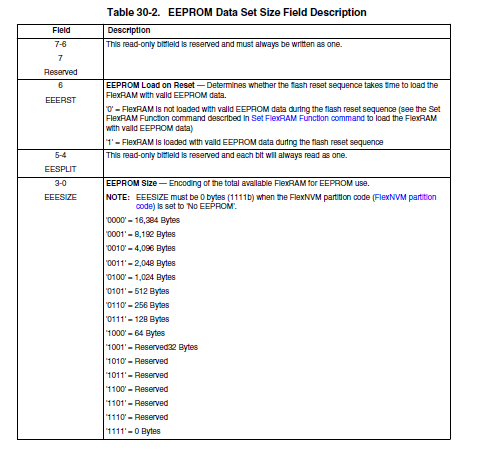

I"m having problems getting my MK10 to set the Partition information correclty .
I've created code  that has worked perfectly on a MK70FX512 system and am porting this code to the MK10FX512 system.
I've modified the code slightly to add the EEERST bit to the partition information.  When running this code it actully completes the SetPartitionInfo command with  success = 1, but when it tries to Printf the message that it was sucessful the system prints out part of the message.. and then begins spitting out garbage.  If I put an incorrect value for EEESPLIT the
SetPartitionInfo command does fail with success = 0, and the printf failure message prints as expected.
#define  EEESIZE_VALUE  0x03        //Size of EEPROM is 2K
#define  EEESPLIT_VALUE 0x00        //Read Only (Always read as a one)
#define  DEPART_VALUE   0x04        // 64K of Backup EEPROM bytes.
#define  EEERST_VALUE   1            //Flex Ram is Loaded with valid data after reset
//*****************This is the code I'm calling when I want to partition the device.  The triggerFCCOBinRAM has been setup appropriately and copied to RAM to run.    This exact code functions perfectly in an MK70FX512 system.
     // Partition the memory now.
      if (SetPartitionInfo(EEERST_VALUE,EEESIZE_VALUE, EEESPLIT_VALUE, DEPART_VALUE, triggerFCCOBinRAM))
         printf("FlexNVM_Init() Device partitioning successful.\r\n");
      else
         printf("FlexNVM_Init() Device partitioning FAILED.\r\n");

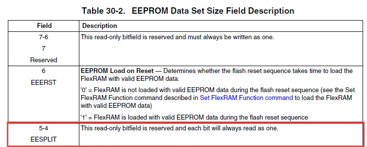

Also. based on my findings, I'm just wondering  is it true then on the MK10FX512 that  since you can't set the EEESPLIT values.. and they are specified as being 11.. Does that mean that the FlexNVM is partitioned into two section each 1/2 the size of the memory?   Or is there just one FlexNVM section in this chip?

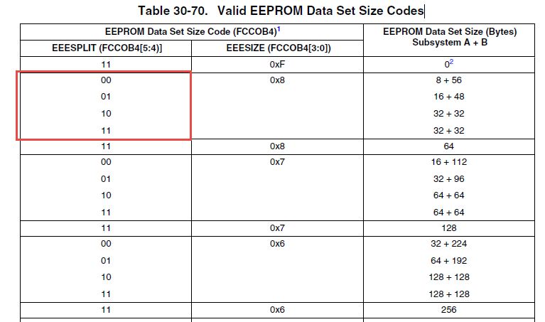

Thank you for the patience.
In fact, the below description should be incorrect, the EESPLIT could be 0b00, 0b01 and 0b10.
So, the Flash command [Program Partition Command] EEPROM Data Set Size Code (FCCOB4) related value, please refer reference manual table Table 30-70. Valid EEPROM Data Set Size Codes:
The Kinetis document team will fix that document issue.
Sorry for that bring any inconvenience to you.
