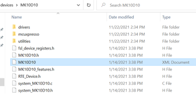

ThorosOfMyr
Where can I find the svd/xml file with peripheral dercription for MK10DX256 family? If not available, is there any compatible?

The MK10DX256 XML File can be found in its MCUXpresso SDK .zip, which can be downloaded through our website: SDK Builder.
Please find below an screenshot, where the XML is located.
Hoping this is what you are looking for, so please, let me know if you have more questions.

Thank you very much!
