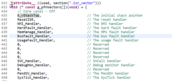

I have such code and after second pass trough crt0 ISR_7 is fired. Can I safely ignore this interrupt or it shows some error in code which I should address? Reference manual of mcu says that this interrupt is reserved.
CRT0 does:
  1. disables interrupts
  2. disables watchdog
  3. setup stack pointer
  4. zero bss
  5. fill stack with canar value
  6. copy data to ram
  7. copy isr table to ram
  8. set pointer to isr table so they run from ram
  9. enables fpu in CPACR
  10. enables PORT clocks
  11. setups clock from external RTC clock
  12. NVIC_SetPriorityGrouping(0)
  13. goes to main function which enables interrupts

Hello @korneliuszosmen,
Usually, for the reserved interrupts, in the g_pfnVectors array is not define:

korneliuszosmen
When I had ISR_7 not definied, I was getting HardFaults

mjbcswitzerland
Specialist V
I have never heard of a reserved interrupt firing and don't think that there is any actual interrupt behind it.
If you are hitting this code it may be that your code is running into it (from another fault) so check the call-stack to see whether it is really arriving there from an interrupt and try stepping back out of the code/interrupt to see where it came from.

korneliuszosmen
Backtrace:
(gdb) bt
#0 ISR_7 () at /<redacted>/crt0.c:291
#1 <signal handler called>
#2 main () at /<redacted>/main.cpp:71
main from line 65:
	asm("CPSIE if");
	//*(uint8_t *)0xFFFFFFFF = (1<<1);
	uint32_t zegar=3000000ul;
	volatile uint32_t i;
	for(i=0;i<zegar/4;i++);
Interrupt fires in busy loop
