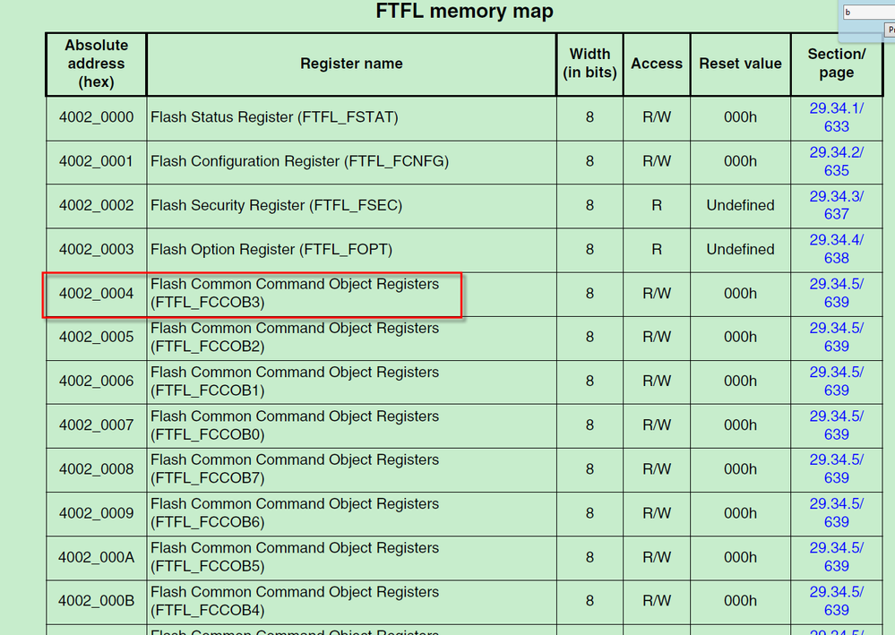

      FLASH_FlashCommandSequenceStart function is used for the flash command operation sequence.
    As you know, every flash operation is using the according command to realize the flash operation function by write the FCCOBx register.
    The index is means how many FCCOB register to control, the base address is defined as FLASH_BASE_PTR->FCCOB3:Just FCCOB3,
  From our flash register table, you will know FCCOB3 is the base address of FCCOBn, just like the following:

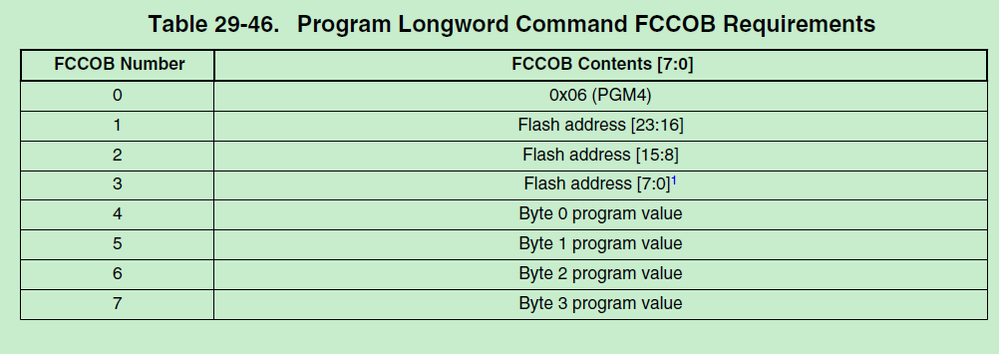

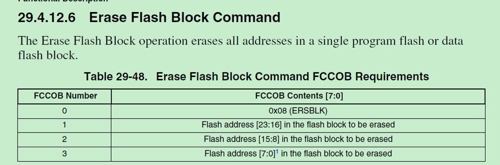

#define ERASE_BLOCK_INDEX      4
#define PROGRAM_LONGWORD_INDEX  8
#define PROGRAM_PHRASE_INDEX    12
The index number should be the number of FCCOB registers which need to control.
(1)ERASE_BLOCK_INDEX 4  means Erase block is just control 4 FCCOB registers:
(2) PROGRAM_LONGWORD_INDEX 8 means  this command should control 8 FCCOB registers:
(3) PORGRAM_PHASE_INDEX 12
I think it should be the Progarm check command, this command should control 12 FCCOB registers:
Please find more detals from our K10 reference manual, chapter 29 .

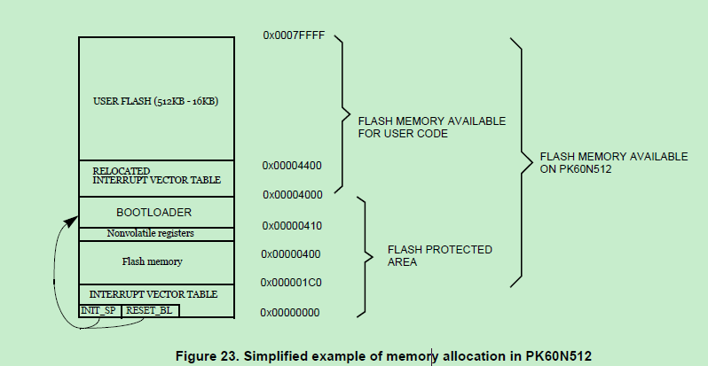

Actually, in AN2295, from address 0x00000410, it is the bootloader code.
I don't know, why you write the word 0x2143 in the bootloader code area.
If you want to realize the function of uart bootloader, you need to modify your application code address, not the bootloader code address.

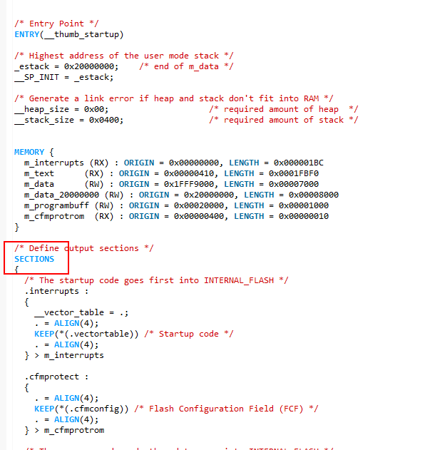

eunseokjung
I'm using CW10.3 with Multilink Universal.
I haven't SECTION part in the Linker file.
MEMORY {
  m_interrupts (RX) : ORIGIN = 0x00000000, LENGTH = 0x000001BC
  m_text      (RX) : ORIGIN = 0x00000410, LENGTH = 0x0001FBF0
  m_data      (RW) : ORIGIN = 0x1FFF9000, LENGTH = 0x00007000
  m_data_20000000 (RW) : ORIGIN = 0x20000000, LENGTH = 0x00008000
  m_programbuff (RW) : ORIGIN = 0x00020000, LENGTH = 0x00001000
  m_cfmprotrom  (RX) : ORIGIN = 0x00000400, LENGTH = 0x00000010
My code has problem when it runs "The debug always error when it run #define FLASH_FlashCommandSequence ((LWord (*)(Byte))&buffer[1])" command.

This is this the SECTION :
from this part , you can find the place of your  ".programbuff"  :
  .m_programbuff : AT(___m_programbuff_ROMStart)
     . = ALIGN(4);
     ___m_programbuff_RAMStart = .;
     *(.m_programbuff) /* This is an User defined section */
     ___m_programbuff_RAMEnd = .;
     . = ALIGN(4);
  } > m_programbuff

Sorry you misunderstand me .
I just tell you how to check the Linker file,  to find the  setion ".programbuff" in it.
Now , i just find there is a error :
change this
   __attribute__((section(".programbuff"))) Byte buffer[200];
to
   __attribute__((section(".m_programbuff"))) Byte buffer[200];
And if still have question , please tell me what'e the problem , and what's your aim.
Alice
