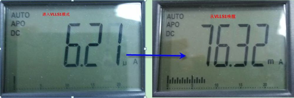

jeremyzhou
Hi Nesrine,
I've attached a TSI_demo_lowpower demo and please refer to it for devtails.
I've also run this demo with TWR-K70F120M and it works fine (Fig1 ).
The demo is compatible with 120Mhz MCU, so it could run with MK10FX512VLQ12 too.
                                                            Fig1  Wake up from VLLS1 mode to RUN mode
