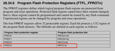

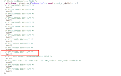

1.step 1 -- set FPROT3 register 0x00 (Essentially, linker_file)

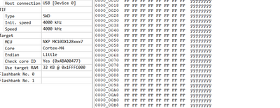

3.step 4 -- wo use jflash to read the code(.bin) ,why  it is all 0xFF,I can't understand what's going on!!!

From your description that the K10 can run fine with CodeWarrior, but can not run in standalong mode and the reading code from 0x00 are all FF. It appears that you do not write the application code and vector table in flash.
Pls check the link file and check the location of the application code and vector table in the codewarioor debugger tools. I suppose that the application code and vector table is put in SRAM.
I suppose that flash configuration field is okay, the protection register does not take effect on the running.

3.step 4 -- The strange thing is that i use j-flash to connect this chip, the entire flash will be erased.

Okay, the K10 works fine with CW tools or standalone.
Because the jflash is third party tools, can you ask the Segger support why the flash is erased when you read flash?
