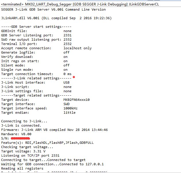

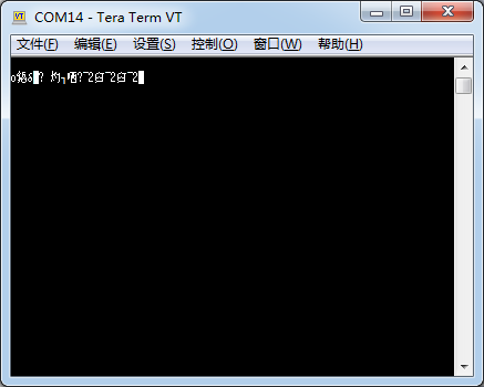

Hi there,
I want to using uart sends character to the pc as following
        * Defines
         #define    DEMO_UART   UART1
         #define    BOARD_DEBUG_UART_BAUDRATE   115200
        * Variables
         uint8_t   txbuff[] = "Uart polling example\r\nBoard will send back received characters\r\n";
         uint8_t   rxbuff[20] = {0};
        * Code
         int main(void){
            uint8_t   ch;
            uart_config_t   config;
            /* Init board hardware*/
            BOARD_InitPins();
            BOARD_BootClockRUN();
             * config.baudRate_Bps = 115200U;
             * config.parityMode = kUART_ParityDisabled;
             * config.stopBitCount = kUART_OneStopBit;
             * config.txFifoWatermark = 0;
             * config.rxFifoWatermark = 1;
            UART_Init(DEMO_UART, &config, CLOCK_GetFreq(kCLOCK_CoreSysClk));
            UART_WriteBlocking(DEMO_UART, txbuff, sizeof(txbuff) - 1);
            while(1)
               UART_ReadBlocking(DEMO_UART, &ch, 1);
               UART_WriteBlocking(DEMO_UART, &ch, 1);
         void BOARD_InitPins(void){
            CLOCK_EnableClock(kCLOCK_PortA);
            CLOCK_EnableClock(kCLOCK_PortB);
            CLOCK_EnableClock(kCLOCK_PortC);
            CLOCK_EnableClock(kCLOCK_PortD);
            CLOCK_EnableClock(kCLOCK_PortE);
            PORT_SetPinMux(PORTC, 3U, kPORT_MuxAlt3);
            PORT_SetPinMux(PORTC, 4U, kPORT_MuxAlt3);
kCLOCK_CoreSysClk      @40MHz
kCLOCK_BusClk               @40MHz
FEE   mode
         void UART_GetDefaultConfig(uart_config_t *config)
            assert(config);
            config -> baudRate_Bps = 115200U;
            config -> parityMode = kUART_ParityDisabled;
         #if defined(FSL_FEATURE_UART_HAS_STOP_BIT_CONFIG_SUPPORT) && FSL_FEATURE_UART_HAS_STOP_BIT_CONFIG_SUPPORT
            config -> stopBitCount = kUART_OneStopBit;
         #endif
         #if defined(FSL_FEATURE_UART_HAS_FIFO) && FSL_FEATURE_UART_HAS_FIFO
            config -> txFifoWatermark = 0;
            config -> rxFifoWatermark = 1;
         #endif
            config -> enableTx = false;
            config -> enableRx = false;

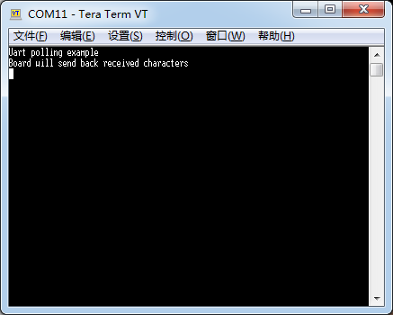

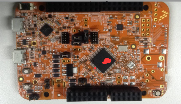

but when using FRDM-K22F runs uart_polling_transfer.c but SYSTEM_CLOCK @40MHz, BUS_CLOCK @40MHz, also in FEE mode, it runs good.
How can i fix the problem, the mk02 also can output the right message?
Thanks in advance!
-Jack

Hi Jack Xu
I saw in the other thread that they asked you for some information, you didn't tell them what value you have in your Baudrate. You put the code that calculate the baudrate, but the actually value depends in srcClock_Hz. So a way to completely  verify this value is if you debug your code to the point where it calculate the baudrate and write the UARTx_BDH and UARTx_BDL values.
