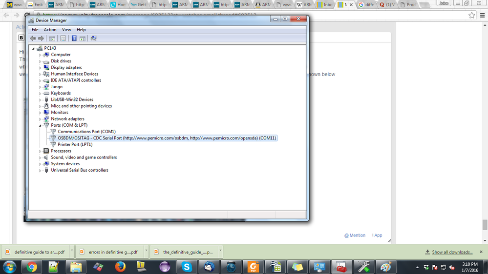

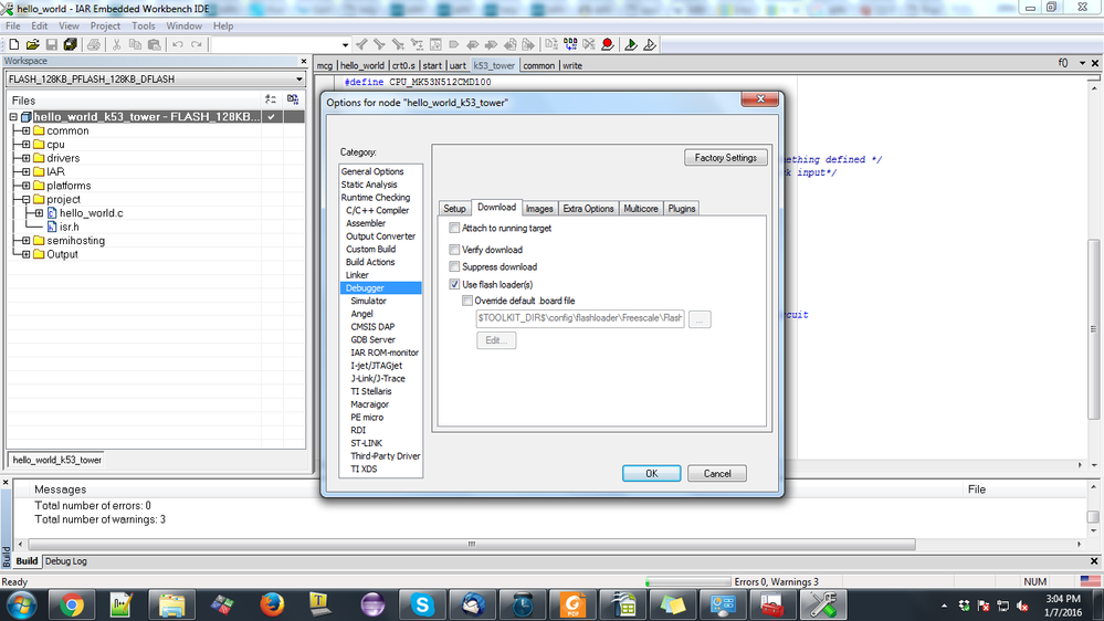

joicemarkose
Hi Jingjing,
Thanks for the quick reply.
while connecting the twr board without twr ser board, the OSBDM/OSJTAG COM port is visible but unable to download the code.
we were able to download the code by removing   flash loader option through options/Debugger/download/use flash loader. as shown below
still the hello world is not working. :smileysad:
Hope to hear from you soon.
