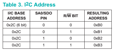

I am trying to interface MAX21000CQ Gyro with FRDM-K20D50M board Through I2C, I am having a confusion of address selection, please refer the following table
By default I have connected SA0 PIN to logic 1 ,
when I am sending the command, i.e GI2C1_WriteByteAddress8(GYRO_I2C_ADDR, GYRO_CTRL_REG_1, GYRO_ACTIVE_BIT_MASK);   in this code
GYRO_I2C_ADDR will be 0xB2  ??
and while receiving data i.e GI2C1_ReadAddress(GYRO_I2C_ADDR, (uint8_t*)&addr, sizeof(addr), &InpData, sizeof(InpData));    in this
GYRO_I2C_ADDR will be 0xB3.  ??
I am confused with the R/W bit addressing. So Please look into the matter.

Thanks for the reply. I think if we are using PE component i.e GenericI2C , So we need to have 7 bit address i.e in your example we select 0x1C or 0x1D according to SA0 bit. the final 8th bit value is done by the write and read command of the PE component.
So in my case the address which I had to write is 0x59 instead of 0xB2 or 0xB3  ie 7 bit address. the 8th bit will be automatically added by the PE component.

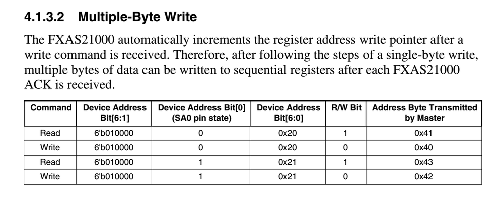

just to clarify,  While exploring I found out that the FXAS2100 gyro from freescale has the following configuration
So in this case also we need to select 7 bit address according to SA0 pin ie 0x20 or 0x21. the 8th bit will be added by the PE component??
i.e GI2C1_WriteByteAddress8(); and GI2C1_ReadAddress();  Please correct me if I am wrong. I tried the above address also which I mentioned but while in debug mode my programs hangs in the 1st command i.e write command.

With the SA0 pin low, the 7-bit I2C address for the FXAS2100 is 0x20 followed by the R/W bit. This translates to 0x40 for a write and 0x41 for a read. An alternate I2C address of 0x21 (followed by the R/W bit) can be chosen with the SA0 pin high. This translates to 0x42 for a write and 0x43 for a read.

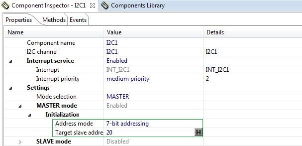

When using an I2C component (I2C_LDD) in Processor Expert, just write the selected 7-bit I2C address in the properties (Target slave address) as shown below. Make sure to switch the format to the ‘H’ mode, as you are entering hex values.
