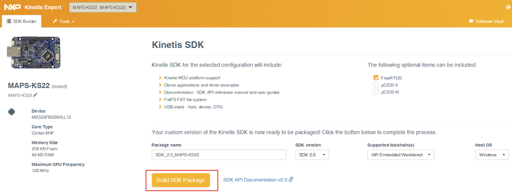

Step1: visit Kinetis Expert website (http://kex.nxp.com/en/welcome) to download MAPS-KS22 KSDK V2.0 software:

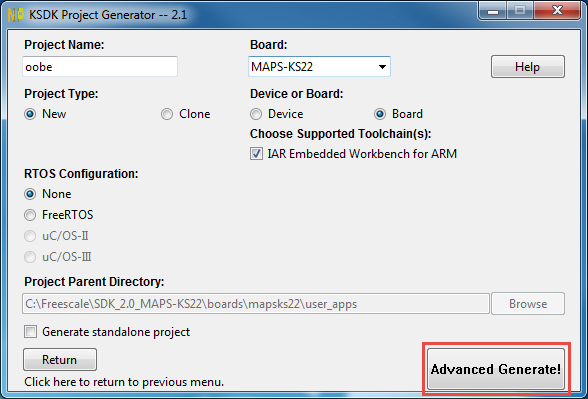

Step2: download [Kinetis SDK Project Generator Tool] from below link and generate oobe demo project based on MAPS-KS22 SDK V2.0 software:
https://www.nxp.com/webapp/sps/download/license.jsp?colCode=KSDK-PROJECT-GENERATOR-TOOL&appType=file...
Step 3: After that, open the oobe project, which located at default path:
C:\Freescale\SDK_2.0_MAPS-KS22\boards\mapsks22\user_apps\oobe\iar

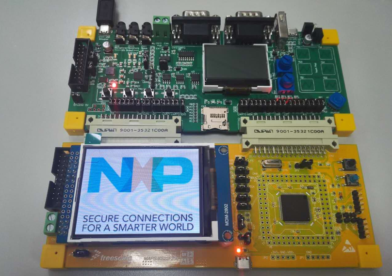

Step 5: We could modify the Freescale logo with new NXP logo, which could using [Embedded GUI Conversion Utility3.0] tool.
This tool could be downloaded from below link:  http://tinyurl.com/eGUI-Convert
The conversion result of the graphic data is 16-bit array, which need be transfer to 8-bit array. After that, compile and download the image to the board, it with below result:

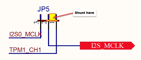

For the KS22 with FlexIO module, the demo will use FlexIO emulating I2S bus to transfer data to WM8960 codec chip. About I2S bus MCLK clock source, the MAPS-KS22 provide two selection, one is using TPM1_CH1 pin, the other one is using I2S0_MCLK pin with JP5 jumper selection. In oobe demo, we use TPM1_CH1 pin to generate 12MHz MCLK clock with TPM module output compare mode. Related code, please refer below tpm_init_output_compare() function at <main.c> file:
