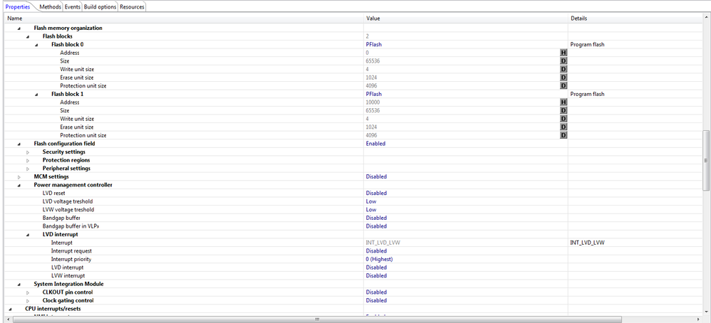

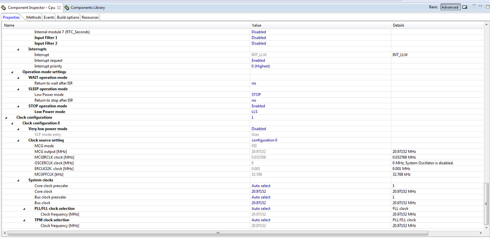

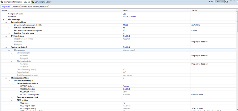

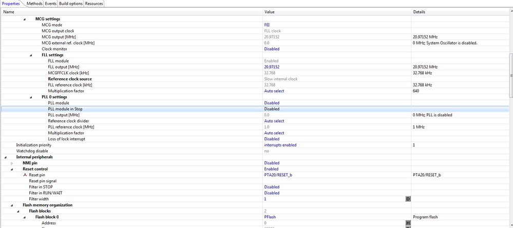

haroldvogel
Here are images of the CPU clock information.  Which seems to go along with the information or at least some of the information above, but I still don't know how to put the CPU into a sleep mode where it will wake up every few milliseconds to poll the system perform tasks and then go back to sleep.
