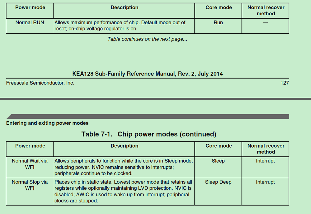

punithb
Is it possible to wake the controller from GPIO interrupt method instead of
RTC timer interrupt?.

kerryzhou
Hi punith,
  From the reference manual:
  You can get that the interrupt can wake up the sleep mode, so you can use GPIO interrupt to wake up the sleep mode.
Jingjing
