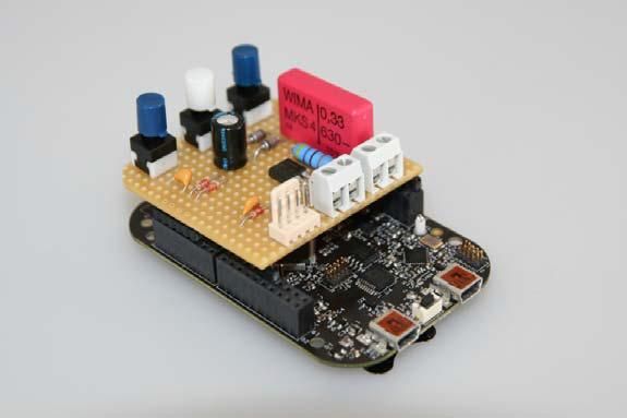

       -Freedom development platform with universal motor drive board extension
The phase angle control technique is used to adjust the voltage applied to the motor. A phase shift of the gate’s pulses allows the effective voltage, seen by the motor, to be varied. All required functions are performed by just one integrated circuit and a small number of external components. This allows a compact printed circuit board (PCB) design and a cost-effective solution.
