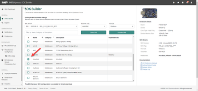

Download the SDK for the K64, be sure that the MCU boot feature is selected:
https://mcuxpresso.nxp.com/en/welcome

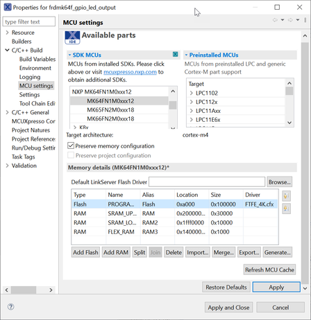

For the example, I’m going to use gpio_led_output. To prepare the example to work with the bootloader, you would need to do the following steps:
  • In properties / C/C++ Build / MCU settings set the start of the flash to the 0xa000, this to preserve the bootloader section:

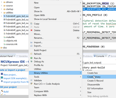

Generate the binary for the image to load.

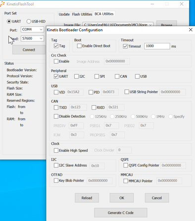

  • Write BCA
    • Create the BCA, this field is to manage the different features of the bootloader. To generated this, the KinetisFlashTool can be used, you can find it in the following link. In this options you need to add the tag, the peripheral used to communicate and a timeout to have a time frame to call again the bootloader without need to call it from your application. Click OK and save the BCA to the image.

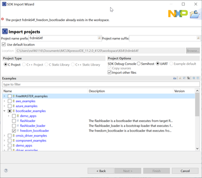

The bootloader can be found in the SDK examples:
In the bootloader_config.h, change the BL_FEATURE_ENCRYPTION_KEY_ADDRESS for outside the code you would load, in this case, I'm going to use the 0xF000:
#define BL_FEATURE_ENCRYPTION_KEY_ADDRESS 0xf000 // NOTE: this address must be 4-byte aligned.
After this, load the firmware to the MCU.

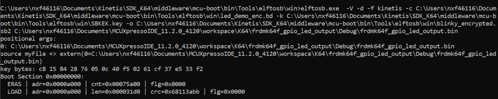

  • Create the SB image from the binary,
    • Use option -k to pass the key generated before
    • Use option -f to define the device. Device must be kinetis to be able to use a 128 AES key
    • Use option -c to load the bd file. (see attached)
    • Use option -o to define the output
Command: elftosb.exe -V -d -f kinetis -c (bd file path) -k (key path) -o (output path).sb2 (image path)

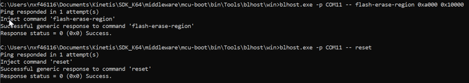

  • Erase the memory section to load the program and reset the device
 Command: blhost.exe -p COMx – flash-erase-region 0xa000 0x10000

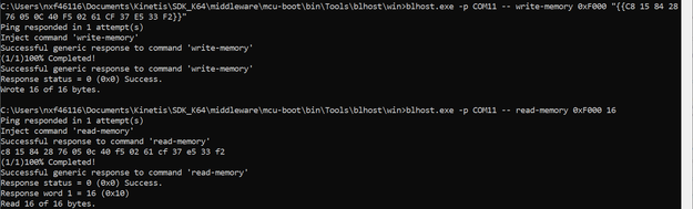

  • Program AES key, same as generated in the previous step. Load it to the memory section previously defined in the  BL_FEATURE_ENCRYPTION_KEY_ADDRESS and confirm that the key was loaded correctly:
Command: blhost.exe -p COMx – write-memory 0xF000 “{{key generated}}”
Command: blhost.exe -p COMx –read-memory 0xF000 16

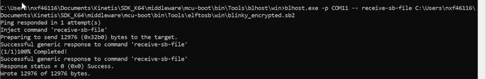

  • Load the SB file
Command: blhost.exe -p COMx – receive-sb-file (path encrypted sb file)
After a reset the application should run correctly.
