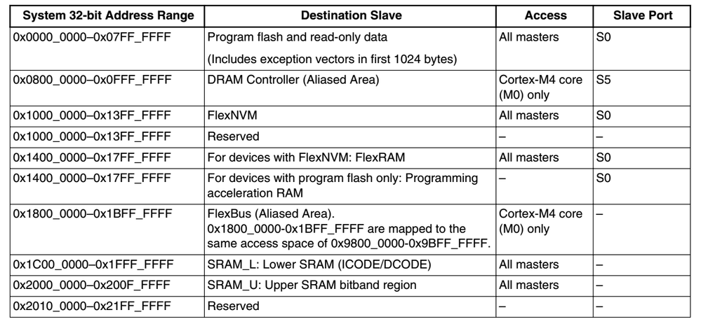

I have a project in IAR for MK10FN1M0xxx12. I suspect my linker file is not good. I took it from some project.
Can you look into it and tell me if it's good for MK10FN1M0xxx12?
If I compare it with the one provided with IAR - I see some differences. But I cant use the IAR linker cause the startup code uses
define exported symbol __VECTOR_TABLE = 0x00000000;
define exported symbol __VECTOR_RAM = 0x1fff0000;
define exported symbol __BOOT_STACK_ADDRESS = __region_RAM2_end__ - 8;
and I don't have these defines in the original IAR linker file.
actually it contradicts the memory table

Both IAR files are correct; one is leaving space for vectors (although more than needed) at the start of SRAM and the other not (for use when interrupt vectors remain in Flash).
Possibly the SRAM_L in the user's guide is wrong since it starts physically at 0x1fff0000 and not at 0x1c000000 as stated (although the statement may be indicating something else, but not relevant for this case).
The same linker script file can be used for all Kinetis (K) parts with the same memory size.

All the sample projects are for K60-K70 may be for K10 it's different a bit?
