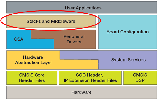

lwIP stack on KSDK
    - <ksdk_install_dir>/middleware/tcpip/lwip

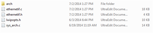

lwIP stack on KSDK – Adapter code
  • <ksdk_install_dir>/middleware/tcpip/lwip/port
  • <ksdk_install_dir>/middleware/tcpip/lwip/port/arch
  • These Adapter code could be divided into four types:
        Ethernet driver adapter code
        OSA adapter code
        Additional code
        lwIP stack configuration code

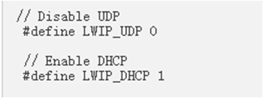

lwIP Stack Configuration Code
  • Provides a way to override much of the behavior of lwIP based on opt.h.
    − Module support (Code size)
          Default inclusions:
    ARP (LWIP_ARP)
    UDP (LWIP_UDP) and UDP-Lite (LWIP_UDPLITE)
    TCP (LWIP_TCP) -- this is a big one!
    Statistics (LWIP_STATS)
        Default exclusions:
   DHCP (LWIP_DHCP)
   AUTOIP (LWIP_AUTOIP)
   SNMP (LWIP_SNMP)
   IGMP (LWIP_IGMP)
   PPP (PPP_SUPPORT)

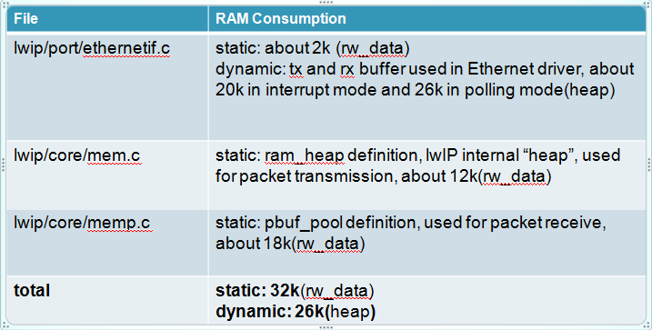

In current KSDK, the main RAM consumption for lwIP is show below:
  • If resource on the new platform is not enough, could reduce ram consumption for ram_heap and pbuf_pool.
        In lwip/port/lwipopts.h:
#define MEM_SIZE                (12*1024)    /**the size of ram_heap/
#define PBUF_POOL_SIZE          10      /*the number of buffers in the pbuf pool. */
#define PBUF_POOL_BUFSIZE       1518 /* the size of each pbuf in the pbuf pool. */
  • pbuf_pool also support dynamically allocate from ram_heap.
       In lwip/include/opt.h:
         #define MEMP_MEM_MALLOC     1 /*Use mem_malloc/mem_free to do allocate*/
  • Use libc malloc/free to manage the memory allocation instead of mem_malloc/mem_free, memory definition for ram_heap is not needed.
        #define MEM_LIBC_MALLOC       1 /*Use malloc/free/realloc provided by C-library*/
