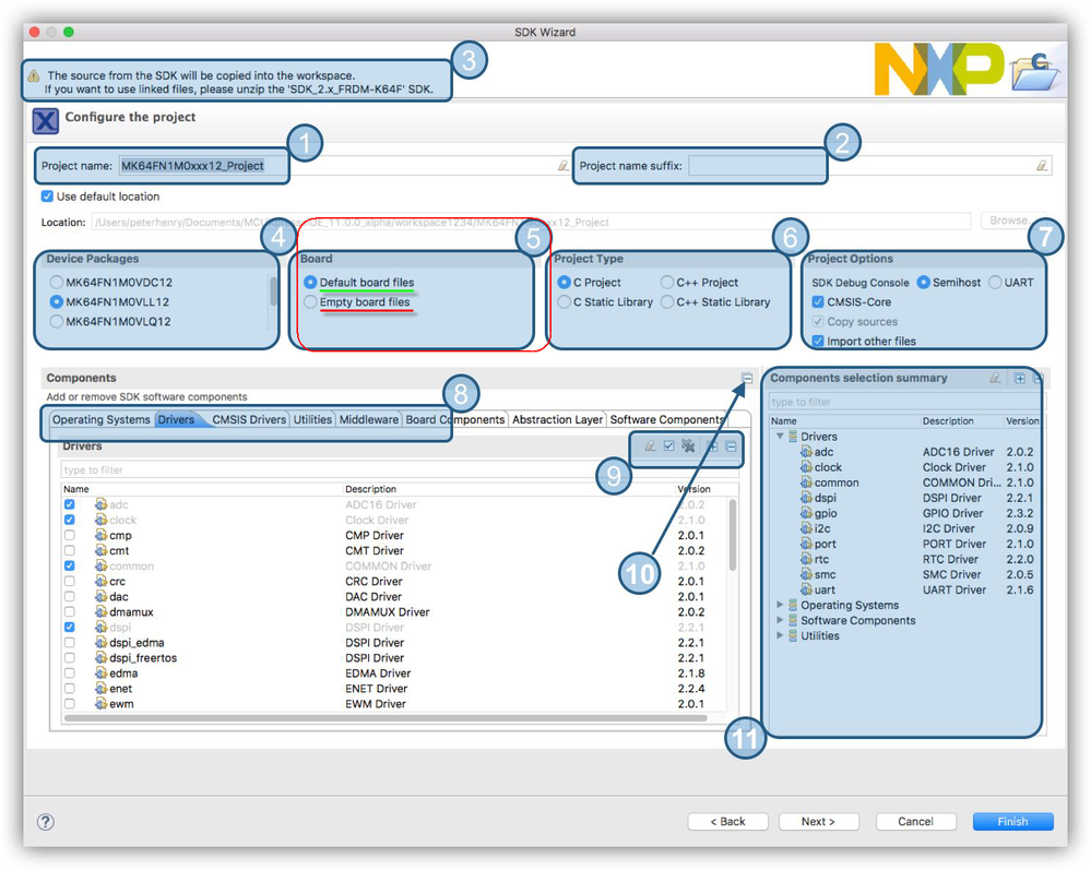

stevenlutz
What does it mean when pins and peripherals are colored light green when starting a new project?
How do I clear everything and start from scratch?
I'm working with the twr-mke18xf
Tags (2)
1,639 Views

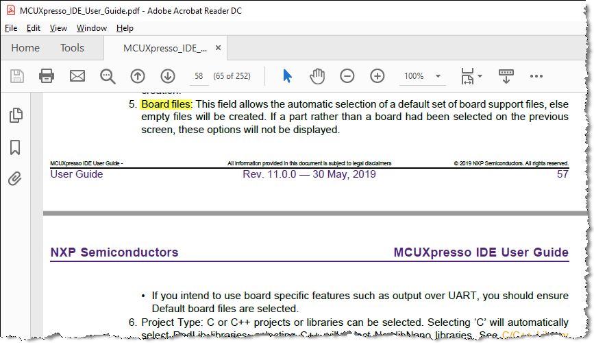

Robin_Shen
Hi Steven Lutz,
If Default board files is select, then you will see pins and peripherals are colored light green.
Please try to select Empty board files.
Robin
