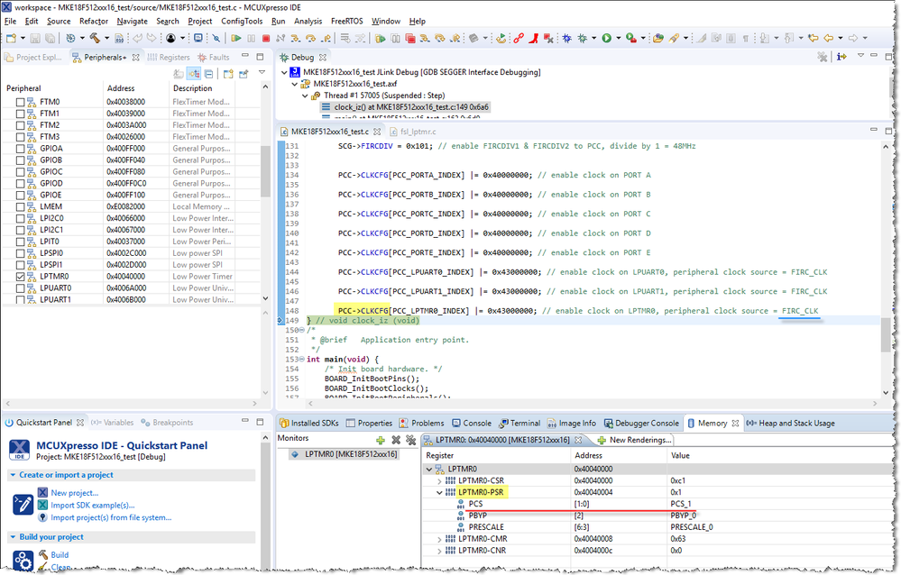

Yes I use MCUExpresso IDE for debugging the project.  There were no faults shown in the “Faults” TAB.  Also the while(1) loop in main continues to run.  Also, note that the LPUART1 port IS working.  The problem is that the LPTMR0 stops.  My clock_iz code is this:
void clock_iz (void) {
       SCG->FIRCDIV = 0x101; // enable FIRCDIV1 & FIRCDIV2 to PCC, divide by 1 = 48MHz
       PCC->CLKCFG[PCC_PORTA_INDEX] |= 0x40000000; // enable clock on PORT A
       PCC->CLKCFG[PCC_PORTB_INDEX] |= 0x40000000; // enable clock on PORT B
       PCC->CLKCFG[PCC_PORTC_INDEX] |= 0x40000000; // enable clock on PORT C
       PCC->CLKCFG[PCC_PORTD_INDEX] |= 0x40000000; // enable clock on PORT D
       PCC->CLKCFG[PCC_PORTE_INDEX] |= 0x40000000; // enable clock on PORT E
       PCC->CLKCFG[PCC_LPUART0_INDEX] |= 0x43000000; // enable clock on LPUART0, peripheral clock source = FIRC_CLK
       PCC->CLKCFG[PCC_LPUART1_INDEX] |= 0x43000000; // enable clock on LPUART1, peripheral clock source = FIRC_CLK
       PCC->CLKCFG[PCC_LPTMR0_INDEX] |= 0x43000000; // enable clock on LPTMR0, peripheral clock source = FIRC_CLK
} // void clock_iz (void)
Does this information change your response?  Thank you for your time to look at this.

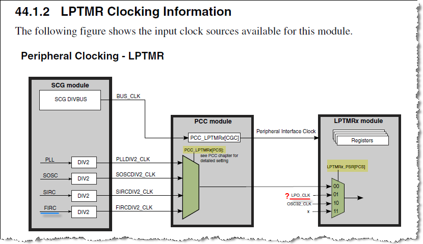

Hi Ammar,
Please ensure the LPTMR0_PSR[PCS] configure the same clock source.
For example:  LPTMR0_PSR[PCS] = 0
Robin

Hi Robin, Thank you for the response.  Please note the following observations:
1) Everything works fine when using LPUART0
2) LPTMR0 works perfectly until sometime after the LPUART1_TX IRQ Handler is called
3) LPTMR0_PSR[PCS] is 00 out of reset and I do not change this in my code => maybe your code changes this somewhere?
Does this change your response?
